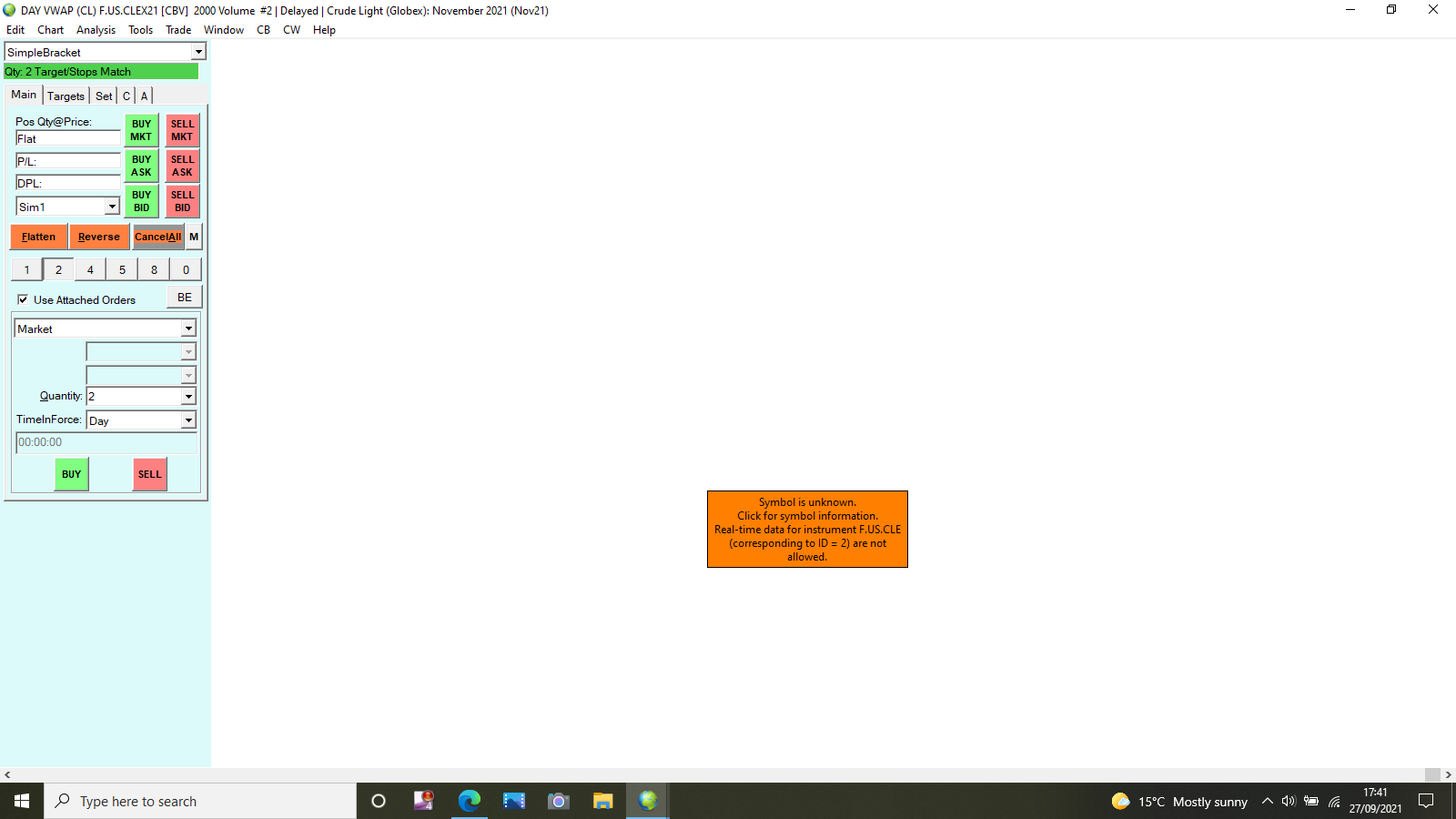

I have successfully connected to the CQG account. However I get an error message saying symbol is unknown when translating symbols. I am not worried about this as I intend to just use the amp account to qualify for non pro data fees via the denali feed. I am desperately trying to get my amp funded account verified by yourselves in order to upgrade to the service package 11. For some reason this is proving rather difficult to achieve. I understand Amp have contacted you as well about this. I really don't understand why this is happening. Many thanks.

imageScreenshot (535).png / V - Attached On 2021-09-27 16:44:36 UTC - Size: 89.01 KB - 290 views

You connected to the CQG system correctly and your verification date for non-professional status has updated. You can view the status of this at the following link:
https://www.sierrachart.com/UserControlPanel.php?page=DenaliDataFeed#Exchanges
The message you are receiving is because you are not setup to get the Real-Time data from CQG. Since you will be setting up the Denali Exchange Data Feed, you do not need to worry about this.
