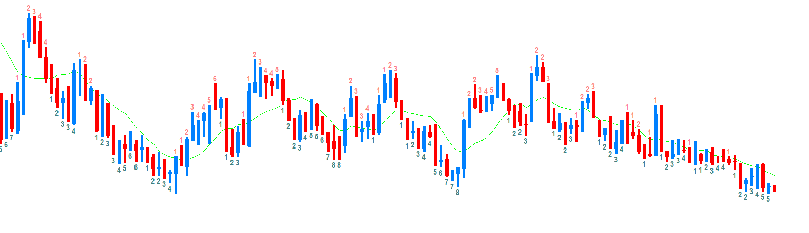

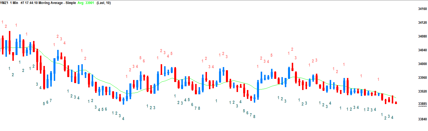

[2021-09-20 15:46:59]
User361939 - Posts: 170
TY John for answer.
I did ask you suggested nad numbers appear but, they are not from source chart. Study start to calculating values for chart where overlay has been added.
Screens at the attachment.
Best Regards
Date Time Of Last Edit: 2021-09-20 15:47:12
imagemainchart.png / V - Attached On 2021-09-20 15:46:35 UTC - Size: 31.35 KB - 294 views
imagechartwithoverlay.png / V - Attached On 2021-09-20 15:46:39 UTC - Size: 37.33 KB - 307 views
[2021-09-20 17:22:51]
If you are using the Study/Price Overlay, then they are ONLY from the source chart. It is not possible for the Study/Price Overlay to calculate anything new, it is not what it does.
If these are not the same chart with the same time frame, then you need to look at how it is going to determine where to put the data from the one chart to the other. Take a look at the information for the Study/Price Overlay to determine how the data is getting copied and if it is not going where you want it to be, then you need to adjust the settings to what will work for what you want.
