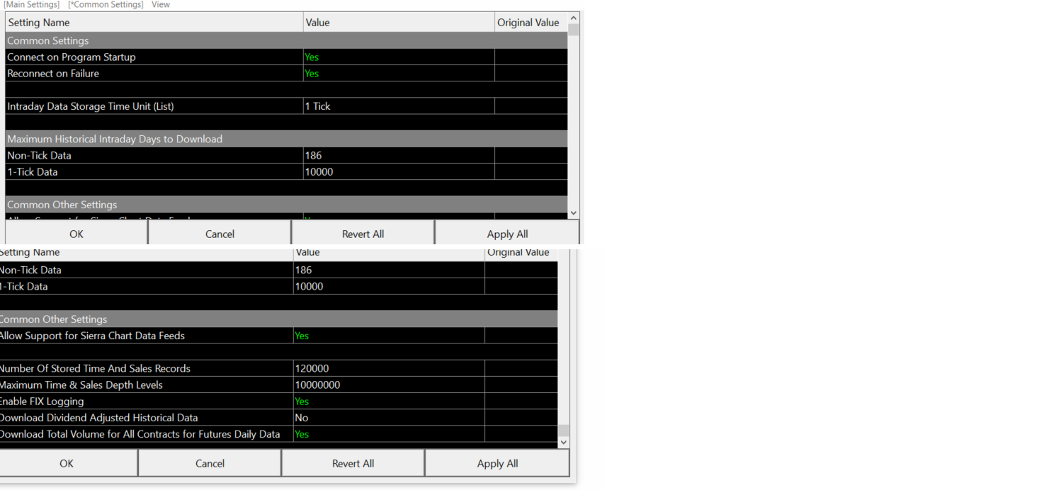

Hi, I did post in a seperate discussion, but to start the suppor again.
John mentioned i needed to Edit > Translate symbols but this has not solved my problem.
I am connecting to rhythmic, but am not getting enough daa flowed through:
1. No historic information
2. Volume data is not appearing/very light
i do get the following in message log:
Triggering next historical data download in queue. | 2021-09-06 15:05:15.916
Notice: Not connected to Live trading account to receive CME realtime futures data at non-professional fees. | 2021-09-06 15:05:15.922
No download requests in the queue to start downloads for. | 2021-09-06 15:05:15.922
I am attaching the updated log after johns suggestion log, and screen shots of my settings
Appreciate the support
imagecommonsettings.png / V - Attached On 2021-09-06 19:13:22 UTC - Size: 95.48 KB - 319 views
attachmentLog.txt - Attached On 2021-09-06 19:14:44 UTC - Size: 38.91 KB - 337 views

[2021-09-06 20:59:53]
Sunit Patel - Posts: 6
Thanks John, I tried changing the service to Rhythmic trading - rather then the DTC, and it seems to load the data, will have a look tomorrow when the market is open.
What's the difference between the 2 services trading, and trading dtc?
[2021-09-07 18:57:34]
The newer direct DTC service, is the updated method for connectivity to Rithmic. The other one will be discontinued.
