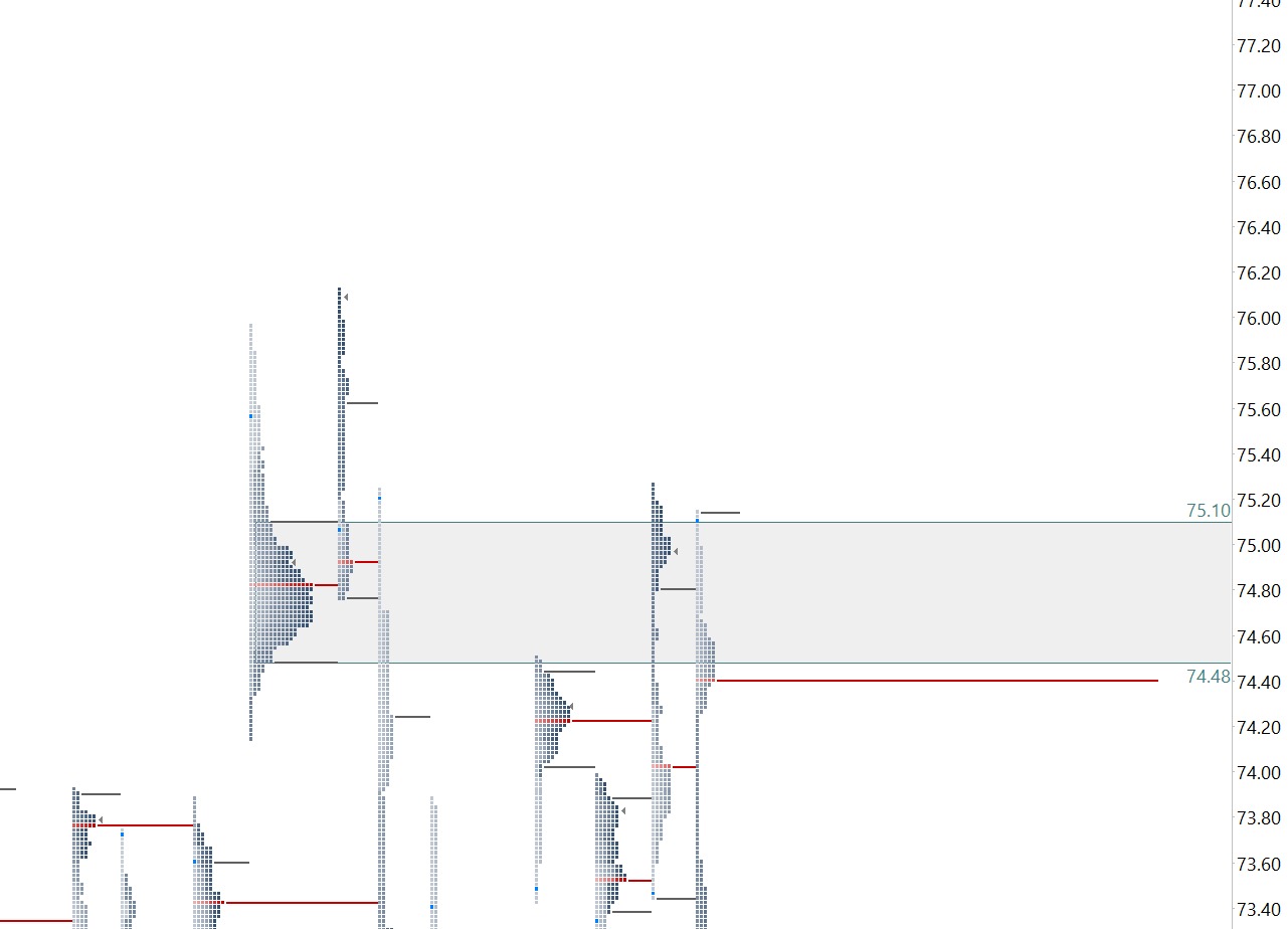

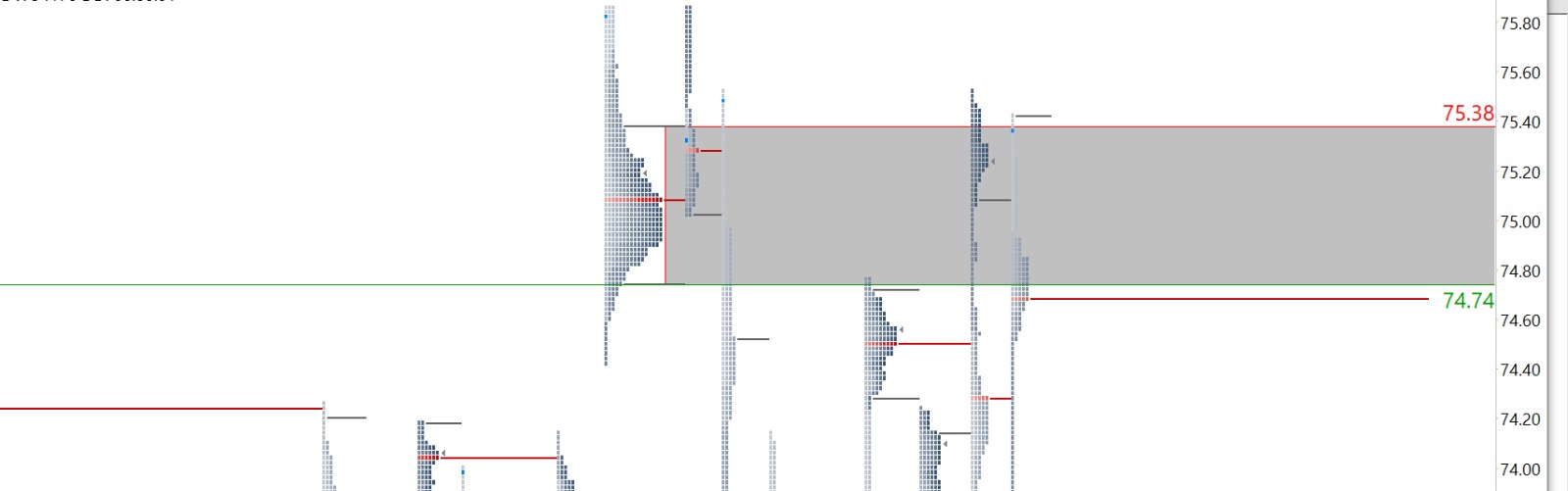

I would like to mention that 1.Cht simple is mine. Secondly , as an example i would like to show you that the market profile from 01.07 and 02.07 which i made a composed market profile area I have the composed value AREA LOW 74.74 and my friend has 74.48. I will attach also, both pictures to point out.

First of all, the Chartbook1.Cht did not have the TPO study on, so we did not have a way to compare what had been created in that chartbook versus the other.
When we added the study and compared the two charts, the Value Area High and Low were identical to each other. Note that in order to determine this, we opened the Tool Values Window and moved the cursor to the TPO for July 1, 2021. There it showed that the Value Area High was 75.08 and the Value Area Low was 74.56. This is using the Denali Exchange Data Feed data.
Since the information you are showing is from an extending rectangle, it's most likely that the difference is just a visual from where the rectangle was drawn. Make sure you compare the precise data by looking at the printed information either on the chart (if you add it) or on the Tool Values Window.
