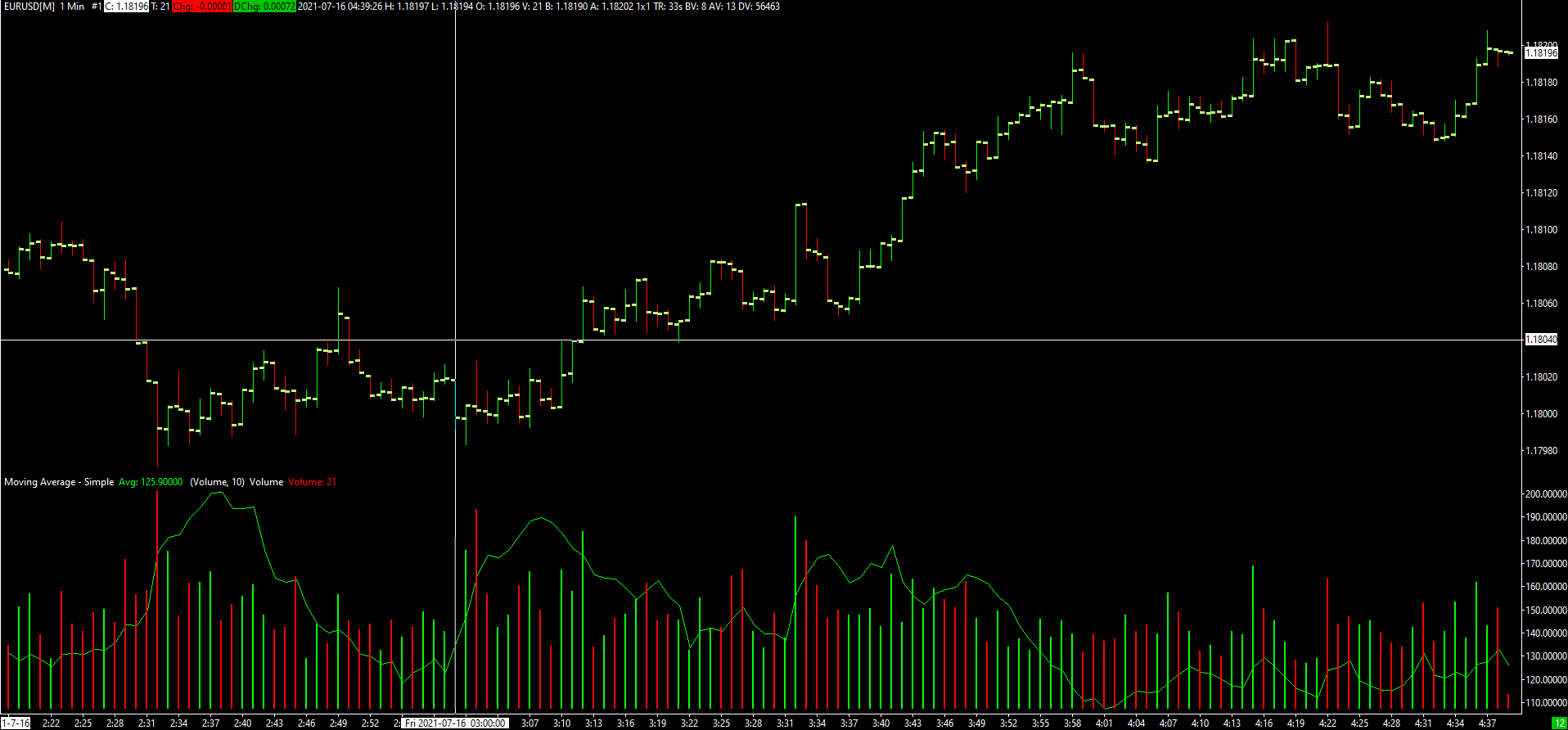

How can I overlay a volume MA line on top of volume bars at the bottom of chart ?
Thanks & appreciate your help
[2021-07-16 09:41:49]
SC Support Tom - Posts: 450
1) Add the Volume study to a chart.
Volume
If this is the only study applied to the chart, then this study will be in Chart Region 2.
Chart Studies: Settings and Inputs Tab >> Chart Region
2) Add the Moving Average - Simple study to the same chart.
In the Settings for this study, set Input Data to Volume, and set Chart Region to 2.
I have attached an image of an example of this.

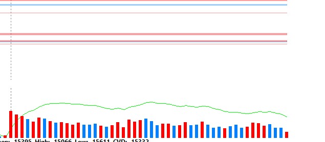

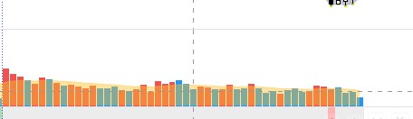

I am not able to add a exponential moving average to volume indicator correctly, it almost seems like it does not sit correctly on volume, usually too far above it. I have played with scaling and it doesn't help. Please compare the screenshots below for the same exponential MA settings.
Thank you

John - SC Support - Posts: 48388
Make sure your Moving Average is based on the Volume study and that the Input is the Volume. Refer to the following for Based On:
Chart Studies: Settings and Inputs Tab >> Based On - Basing a Study on Another Study

User566250 - Posts: 37
Thanks John. I have it set on Volume, but still not getting a correct MA in relation to Volume itself:
imageScreenshot 2022-05-18 141850.jpg / V - Attached On 2022-05-18 18:22:19 UTC - Size: 154.29 KB - 233 views
[2022-05-18 21:09:17]
Make sure the scale for the Moving Average is set to Same as Region. Refer to the following:
Chart Scale and Scale Adjusting: Same As Region (Scale Range)
[2022-05-18 22:45:57]
Thank you. Looks like Volume automatically is set on Automatic zero based. I switched that to Auto and set the MA to Same as Region and works great now.
