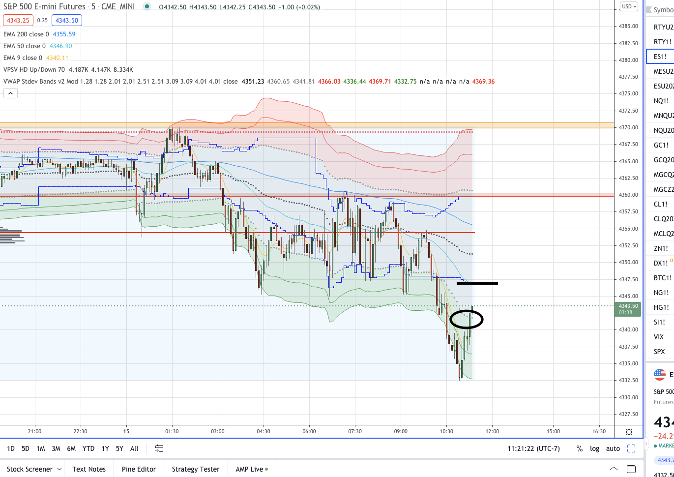

I know there is a way to add value area lines to a chart but there a way they can be dynamice like a ema line that way the user can track the developing value area...please see an example attached
imagesc valare developing.png / V - Attached On 2021-07-15 18:39:48 UTC - Size: 239.97 KB - 749 views
[2021-07-15 19:04:35]
Use the Volume Value Area Lines study and set the Input for Draw Developing Area Lines to Yes. Refer to the information here:
[2021-07-15 20:52:04]
coachted - Posts: 544
thank you thats exactly wehat i was looking for

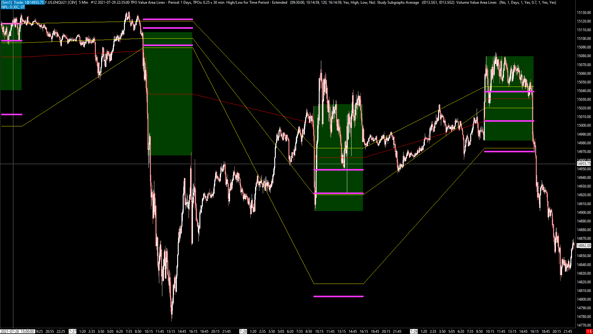

User531256 - Posts: 3
Hi, I was wondering how to remove connecting lines of the VALUE AREA LINES indicator. I only want the lines to display during the day sessions and not connect sessions together.
The TPO VALUE AREA LINES do it perfectly (No connecting Lines between Sessions). I also have the same problem with the STUDY SUBGRAPHS AVERAGE that I use as a midpoint for the High/Low for Time Period Indicator.
The connecting lines between sessions only show up when I squeeze the price bars together. It only allows me to see one session of Value Area lines at a time. I need to squeeze the price bars to see more Value Areas from days ago.
Is there any way to remove the connecting lines or is there is alternative way to achieve this?

58LesPaul - Posts: 429
Is Draw Zeros set to no?
[2021-07-30 15:52:10]
Hi it does not have that option in settings. I'm using the Volume Value Area Lines study, not Volume by Price.
[2021-08-02 09:06:11]
Refer to:
Chart Studies: Avoiding Vertical Joining Line for Study Subgraphs
