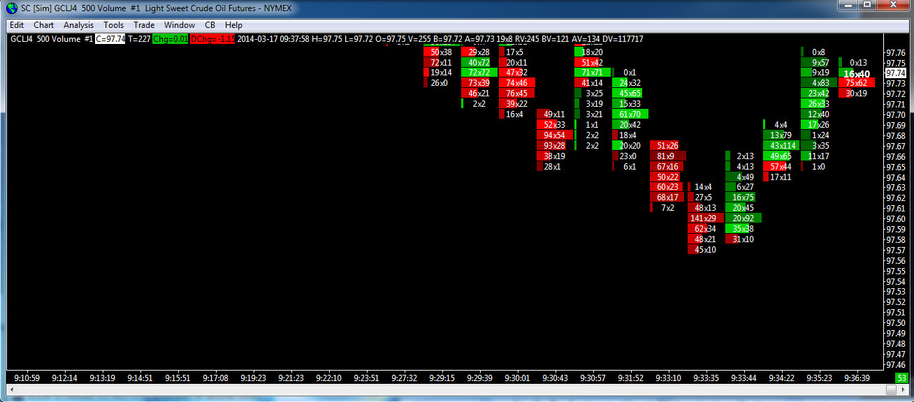

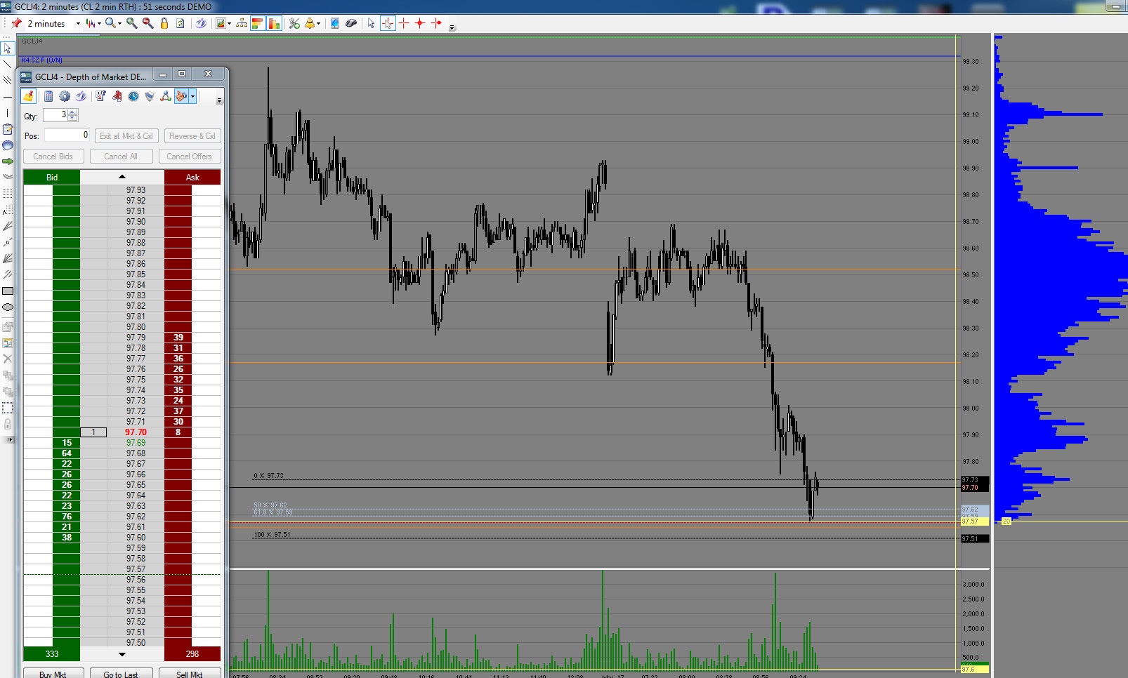

Hi - I'm using the OEC live feed into Sierra Charts and using the number bars study to show me a footprint. The issue is that the Sierra number bars are not accurately displaying the proper ticks and volume that my OEC is giving it. For example, I'm trading the GCLJ4 crude light contract and the low of day on the number bars at 97.57 shows 45x10 i.e. 55 contracts traded. However, my OEC feed (through my trading platform) only shows 20 traded at the 97.57 low. I have checked this with other traders and there were only 20 contracts traded at that low.
Any idea what to do to fix the Sierra Charts/number bars?
Simon
image2014-03-17_093813 Number Bars Error.jpg / V - Attached On 2014-03-17 15:57:19 UTC - Size: 192.25 KB - 624 views
image2014-03-17_093921 OEC Feed 20 at LOD 97.57.jpg / V - Attached On 2014-03-17 15:57:27 UTC - Size: 323 KB - 569 views

We had a look at the OEC historical data that we have, for the apparent time in question and we do see 20 contracts traded at that price:
http://www.sierrachart.com/image.php?l=1395104083374.png
This means that you did not re-download the data after switching to 1 Tick, according to the instructions here:
https://www.sierrachart.com/index.php?l=doc/doc_TickbyTickDataConfiguration.php
There really is no other possibility of getting a different result, unless you changed the Volume at Price multiplier in Chart Settings.
Date Time Of Last Edit: 2014-03-18 00:56:55

AnimalHungry - Posts: 5
Ah yes, thanks! I forced it to delete the data and reload again and now it's showing 20 traded at that 97.57 low. I'll have another crack at it in tomorrow's session.
