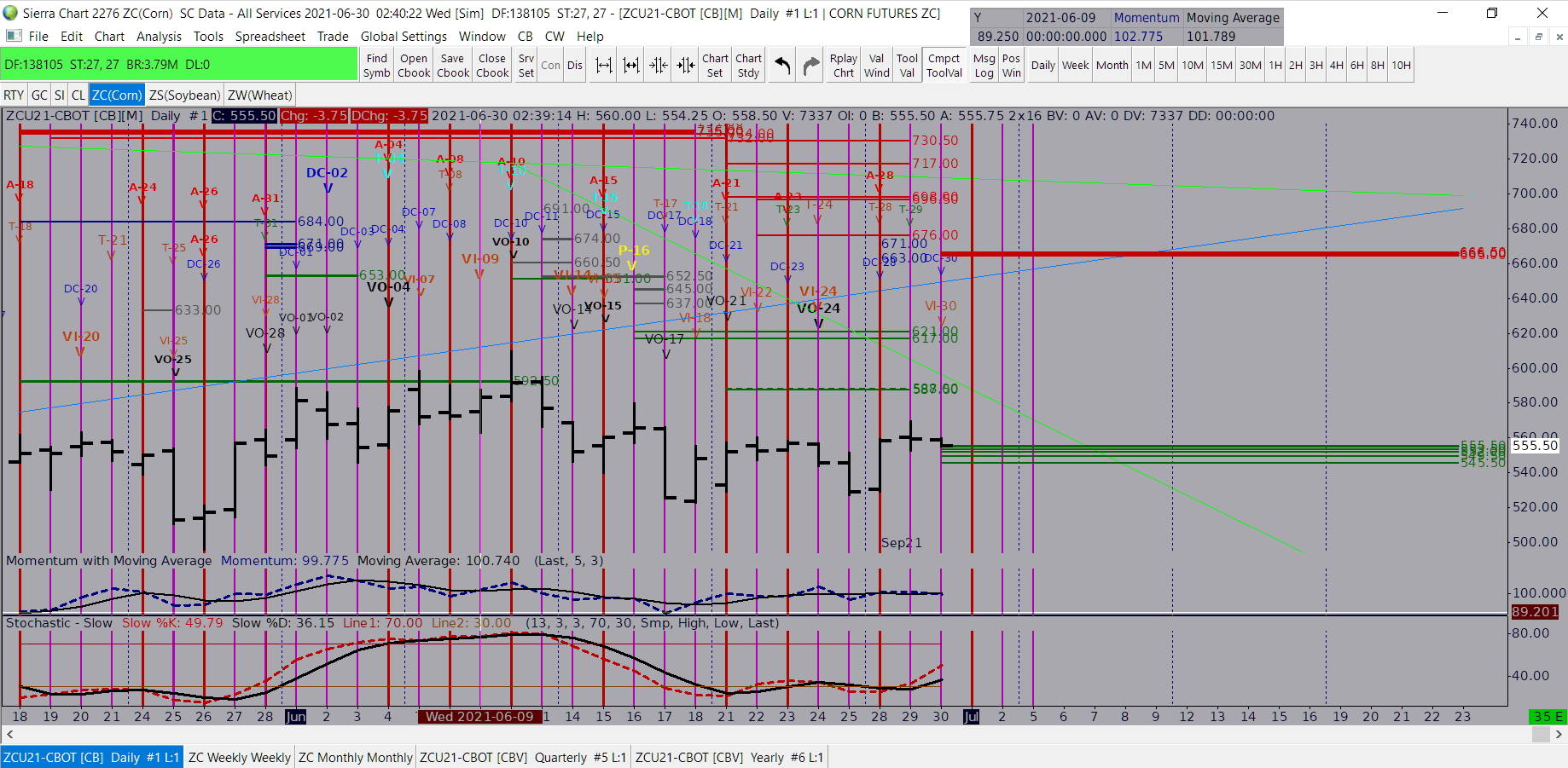

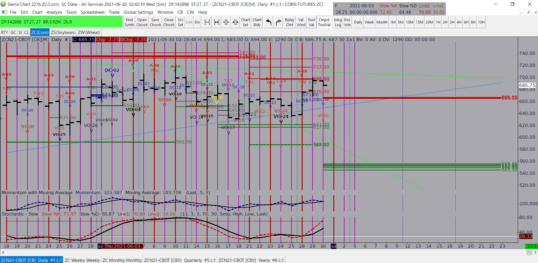

I rolled over my daily chart of ZCN21 to ZCU21 contract. the chart did not keep ZCN21's historical data. see attached screen shots.
Please advise on how to keep historical data of previous contract.
It is a first time that such issue occurs.
imageZCN21BeforeRollover.png / V - Attached On 2021-06-30 06:43:37 UTC - Size: 150.87 KB - 363 views
imageZCU21AfterRollover.png / V - Attached On 2021-06-30 06:43:46 UTC - Size: 151.27 KB - 379 views

[2021-06-30 13:51:09]
User189132:
We do not understand how you are concluding that the historical data for the previous contract is not present. Based on the screenshots you provided we do not see any particular issue. The rollover would have occurred on June 28, 2021 and you have the data showing as expected. If you were expecting to see a price difference at the rollover, then the reason that is not present is because you have selected a Back-Adjusted Continuous Contract option. For more information on Back-Adjustments, refer to the following:
