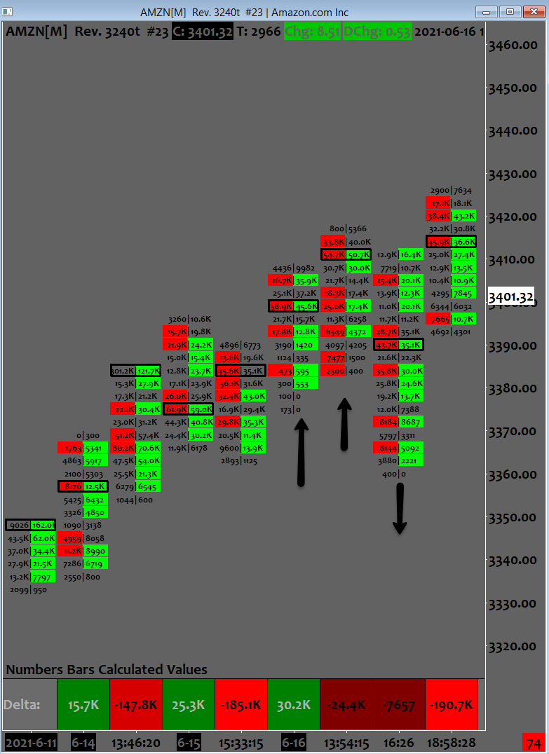

Hello, looking at my Reversal chart it seems like the first bar on the 6/16 is wrongly plotted.
I have noticed it on several occasions, the first two bars are Up bars and it does not look right.
It should be an Up bar then a Down bar as opposed to two Up bars.
If you look at the 6/14 the first bar is an Up bar as well as the second bar.
image2021-06-19_1647.png / V - Attached On 2021-06-19 15:52:12 UTC - Size: 115.91 KB - 434 views

There is nothing that you have displayed that shows whether a bar is an Up bar or a Down bar. The relative position of the bar to the previous bar does not give you the information you need. You need to know where the Open and Close of the bar are located. To do this, you can turn on the Open/Close Markers for the Numbers Bars which would give you the indicator you are looking for. Refer to the following:
Numbers Bars: Open and Close Marker Style
