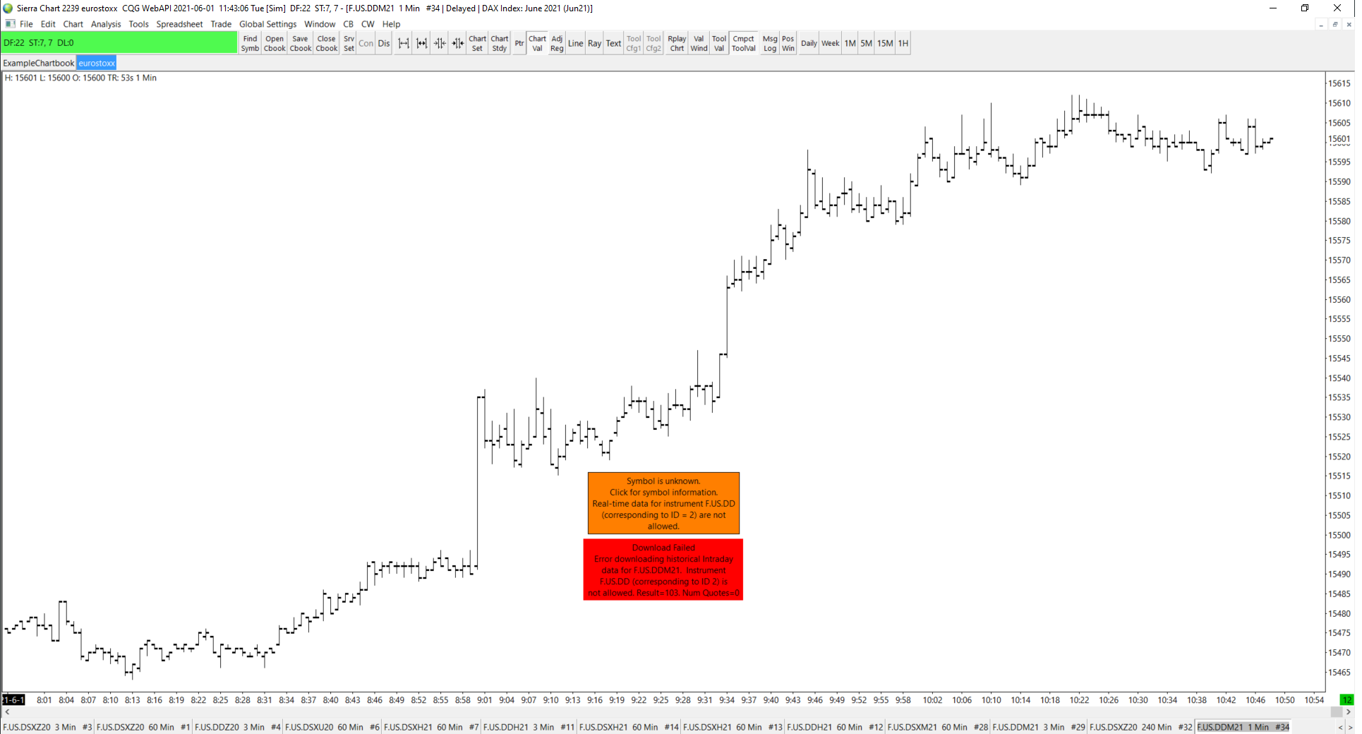

Hello, i was on my account and my laptop went on stand bye. Everything was okay then i went back to the laptop and this happend on the picture. I dont know what i had to do. Because 5min before there was all okay. Can you help me please ?

i read that i that they change to 2 year digit code but i didnt know with the paper on pdf how it work because i tried and it doesnt work. My market ist dow jones eurostoxx 50 how i had to change it in the "find symbol" -- Selected symbol "F.US.DSXM21" that is the old code. What i had to change dont know what to do...

The first thing is to update your system to the latest version to ensure that you have all the updated information. To do this, follow these instructions:
Then update your Symbol Settings, just to make sure you have all the updates. Follow these instructions:
Global Symbol Settings: Update Symbol Settings
Then, open your Chartbooks and select Edit >> Translate Symbols to Current Service. This will ensure that your charts have the correct symbols.

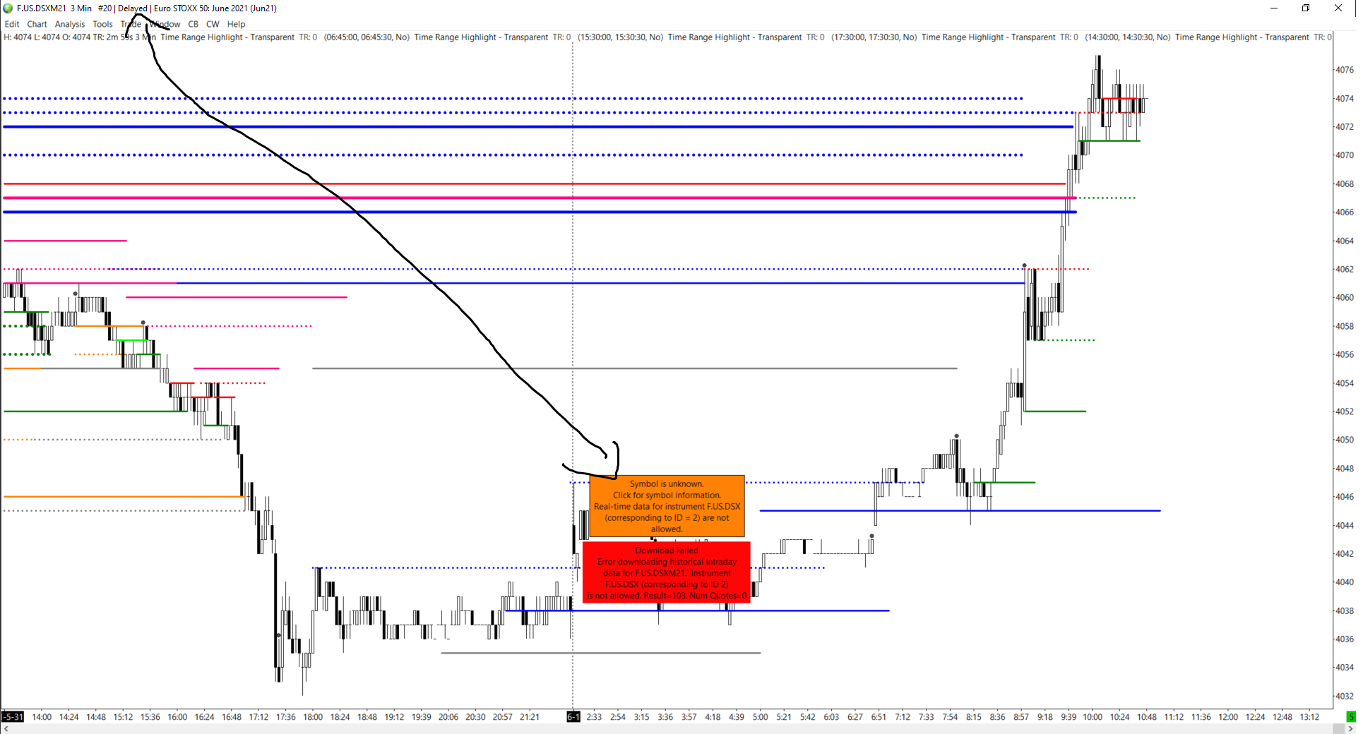

I did all the steps and it still doesn´t work. The red and orange symbol came like in the first post picture what can i do ?
[2021-06-01 14:09:52]
User562957 - Posts: 58
on the top of my chart there stand "delayed" and the orange and red symbol

It looks like AMP took you off the EUREX data.
We really recommend using our data feed anyway, as it is a direct connection to the EUREX. You will find the information for the data feed here:
Denali Exchange Data Feed
The specific Setup Instructions are on that same page, but here is the direct link:
https://www.sierrachart.com/index.php?page=doc/DenaliExchangeDataFeed.php#SetupInstructions_EUREX

Sierra_Chart Engineering - Posts: 25430
We feel like you are forcing customers to take your Denali feed.
Yes this has been planned for EUREX and communicated to users for about three months now, but it has not been implemented. If this has come unexpectedly, then you have ignored that notice. Why?
However, due to an oversight on our part, it was implemented for CQG users on the CQG side, but there may be a billing issue where you are still getting billed for EUREX for June from your broker. We have contacted AMP and CQG regarding this.
If you have been billed, for the exchange fee for June, then we will have the EUREX data restored from CQG. We have already contacted them about this.
