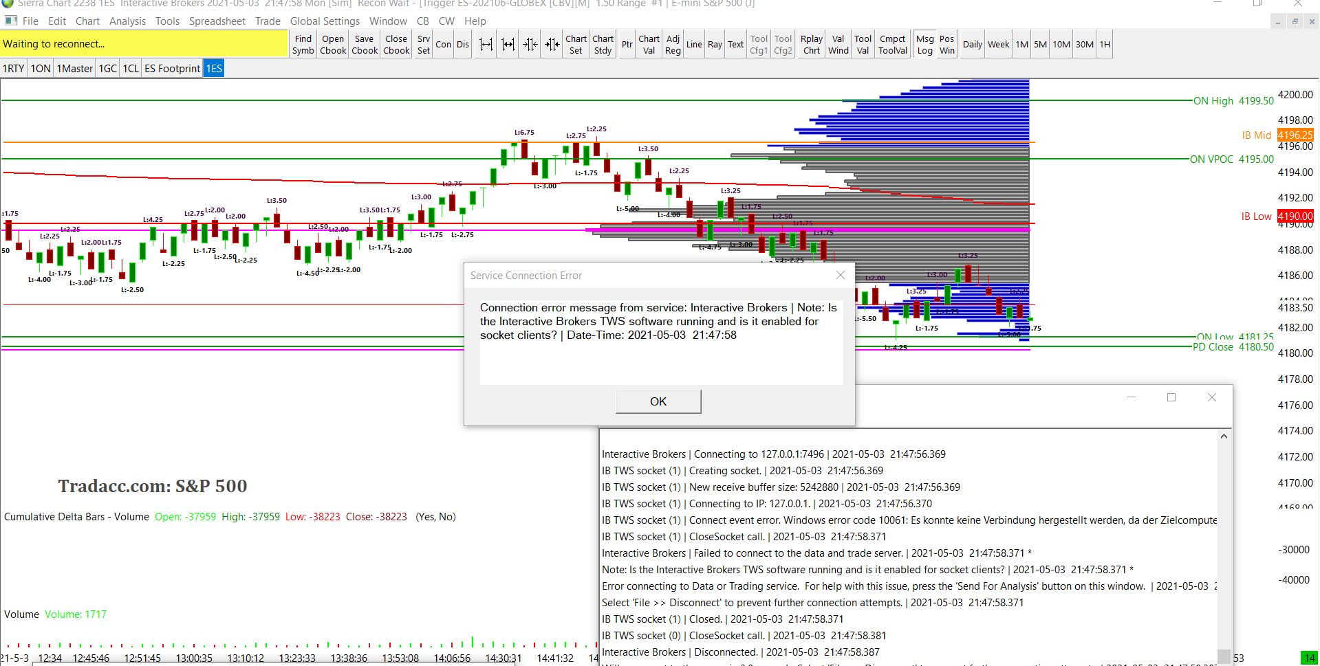

thank you very much for your great service. I have a follow up question; when I close IB TWS, Sierra Chart gives me the error message that I attached.
What does the reconnecting attempt refer to? Only to the trading services or also to data services? (My charts show the M which would mean that they receive the Denali Feed).
I am just wondering as it seems that the connection is lost altogether although the charts should still receive data even when closing the TWS

John - SC Support - Posts: 48520
When the connection to TWS is lost, then the overall connectivity is stopped. We are aware that this is not optimal, but there are just other priorities to deal with and this one has a simple solution, which is to keep TWS running.
