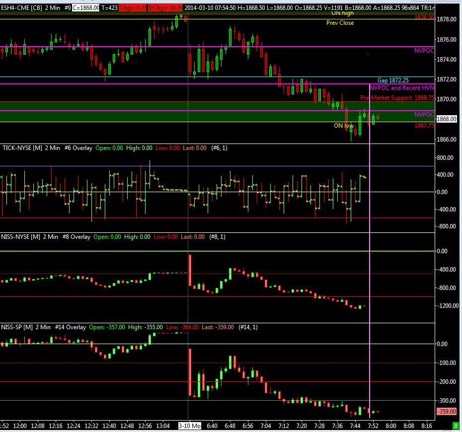

When runnning the tick and internals (NISS NYSE and S&P), they will just stop printing on the chart. I have to go to chart settings and hit apply several times to get them to print again. Screenshot attached. I drew a vertical line down where the tick and NISS-NYSE stopped and you can see that in this case, the NISS-SP continued printing.
imagescreenshot.jpg / V - Attached On 2014-03-10 15:01:04 UTC - Size: 135.37 KB - 565 views

I see now that the tick and internal charts won't stop loading data. It just keeps loading over and over and won't stop. I was able to create new charts for the tick and NISS-S&P and they seem ok now but I'm not able to get the NISS-NYSE to stop loading regardless of how many times I create a new chart for it. This seems to be causing the update issue. I downloaded the pre-release version but it's not helping.
