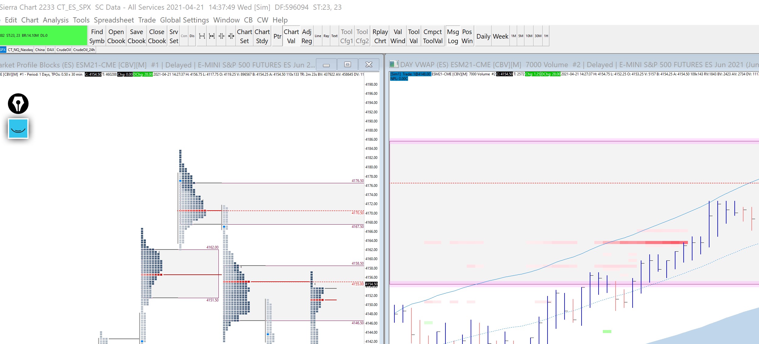

Hi, I activated today real time denali data feed, completed few times a setup instructions Denali Exchange Data Feed: *Setup Instructions: CME/CBOT/NYMEX/COMEX Exchanges*, ​restarted SC of course, but still can see only delayed data.
Can you see some cause in my log?
tSoftware version: 2233 64-bit | 2021-04-21 14:22:00.817
Primary Thread ID: 10420 | 2021-04-21 14:22:00.817
Usage end date: 2021-07-18 | 2021-04-21 14:22:00.817
Enabled for: Advanced Features 2. | 2021-04-21 14:22:00.817
Enabled for: Sierra Chart Historical Data Service. | 2021-04-21 14:22:00.817
Enabled for: Denali Real-Time Exchange Data Feed. | 2021-04-21 14:22:00.817
Enabled for: Delayed Denali Exchange Data Feed. | 2021-04-21 14:22:00.817
Enabled for exchange2: CME (Trading Account Required) | 2021-04-21 14:22:00.817
Enabled for exchange2: CBOT (Trading Account Required) | 2021-04-21 14:22:00.817
Enabled for exchange2: COMEX (Trading Account Required) | 2021-04-21 14:22:00.817
Enabled for exchange2: NYMEX (Trading Account Required) | 2021-04-21 14:22:00.817
Allow Support for Sierra Chart Data Feeds is enabled. | 2021-04-21 14:22:00.817
Current selected Data/Trading service: SC Data - All Services | 2021-04-21 14:22:00.817
Custom symbol settings values: enabled | 2021-04-21 14:22:00.817
Chart Update Interval: 500 | 2021-04-21 14:22:00.817
Intraday Data Storage Time Unit: 0 | 2021-04-21 14:22:00.817
Time Zone: -04:00:00 (EST-05EDT+01,M3.2.0/02:00,M11.1.0/02:00) | 2021-04-21 14:22:00.817
2021-04-21 18:22:00 Local computer time in UTC | 2021-04-21 14:22:00.817
2021-04-21 14:22:00 Local computer time in SC Time Zone | 2021-04-21 14:22:00.817
2021-04-21 18:18:40 Server time in UTC | 2021-04-21 14:22:00.817
Local computer UTC time and Server UTC time difference: 1 seconds. | 2021-04-21 14:22:00.817
Program path: C:\Users\User\Downloads\SierraChart2233\ | 2021-04-21 14:22:00.817
Data Files path: C:\Users\User\Downloads\SierraChart2233\Data\ | 2021-04-21 14:22:00.817
OS Version Number: 10.0 | 2021-04-21 14:22:00.818
Locale Setting: C | 2021-04-21 14:22:00.818
DLLs: UserContributedStudies_64.dll | 2021-04-21 14:22:00.818
Allowed protected custom studies: | 2021-04-21 14:22:00.818
imageSC1.jpg / V - Attached On 2021-04-21 18:39:04 UTC - Size: 334.02 KB - 418 views

You have signed up for the Non-Professional CME exchanges, which means that you need to connect to your live, funded futures trading account at the beginning of each month to qualify for the lower-priced exchange fees. You have not connected to your trading account yet this month. Refer to the following:

I was connecting sierra to my founded IBKR account today according to your manual. But will check it twice tomorrow. Understand it is on CME side. Thanks!

Make sure that it actually makes the connection to IB. The status bar needs to be green.
