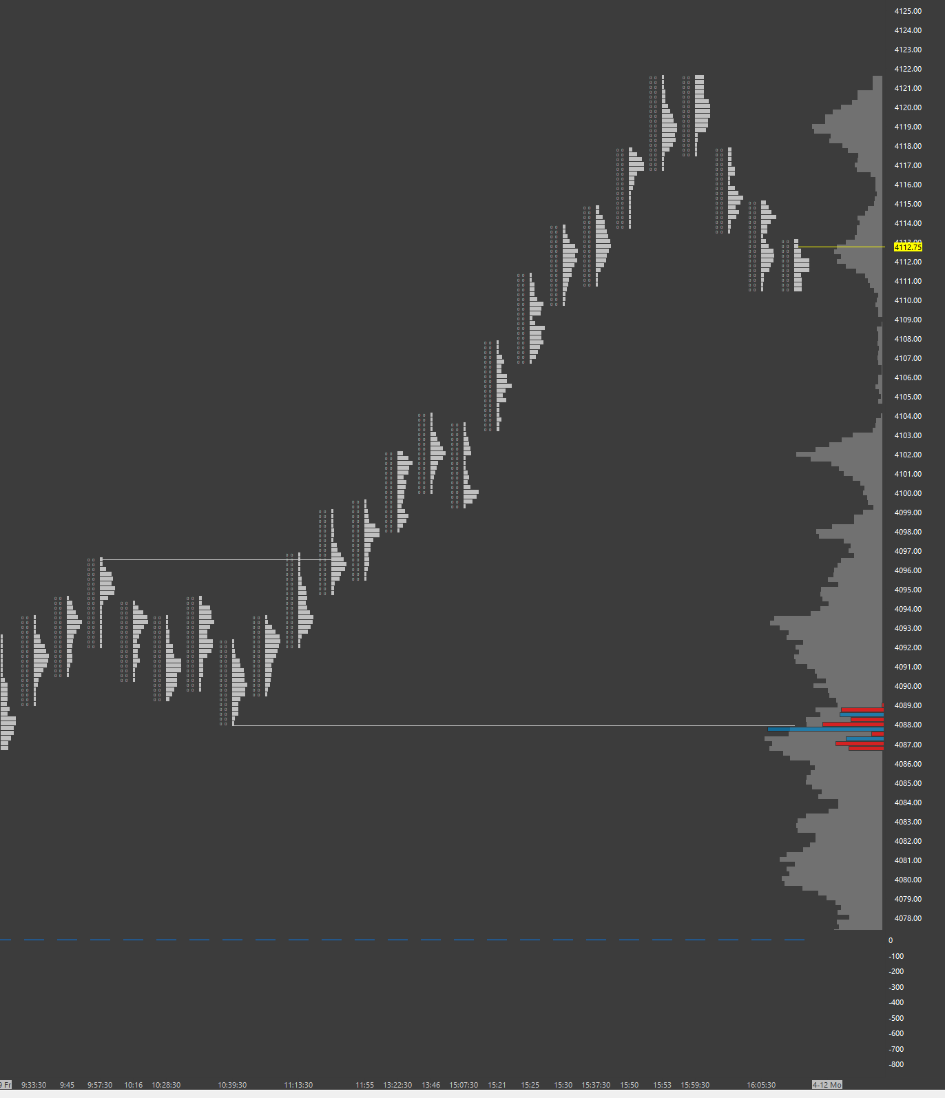

Hello Team Sierra Chart ! I hope all well - I have searched all over your board, but couldn't find a solution to the following problem as attached per picture. I have the right contrat for ES in place and I am fully aware of all the settings. It worked fine in the past depsitte having an Interactive data link (I am aware of the quality). Since the Mar '21 expiry it just stopped feeding my footprint bars, same applies to TPOs which have buy/sell imbalances. My pure TPO charts work fine - What I have done wrong or how can I fix it ?

You need to use the Denali Exchange Data Feed for data. Full details are below:
We are no longer as of December 28, 2020 providing the Sierra Chart provided historical data service for CQG or Interactive Brokers users. For more information, refer to this Support Board thread:
Jan 1, 2021 Changes to Historical Data: Interactive Brokers, CQG
Also refer to this post for steps that you need to do now:
Jan 1, 2021 Changes to Historical Data: Interactive Brokers, CQG | Post: 245144
The solution to this problem is to use the Denali Exchange Data Feed for CME and EUREX data. Step-by-step instructions are here:
Let us know if you need help with the set up and we will help you through all of the steps.
In the case of CQG you will then need to contact your broker and cancel CME and EUREX exchange fees through your CQG account so you do not pay exchange fees twice. You definitively do not have to pay any market data exchange fees through your brokerage account to CQG. This is not required.
