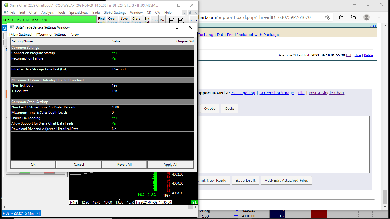

[2021-04-10 01:55:04]
Gtrader510 - Posts: 76
my setting is for max depth 0
Date Time Of Last Edit: 2021-04-10 01:55:20
[2021-04-10 02:16:28]
my dts configure list is also emptyhttps://www.sierrachart.com/Download.php?Folder=SupportBoard&download=50118
image2021-04-09.png / V - Attached On 2021-04-10 02:16:11 UTC - Size: 71.82 KB - 430 views
[2021-04-11 19:48:36]
i have tried everything please help

[2021-04-12 16:24:14]
sir like i already told few time im getting total 100 levels of each side i have checked all the settings they all set to 0 please help this is so annoying.im using epm ehuch is es S&P500 and i have activated cme full depth

[2021-04-12 16:49:43]
Then please do the following:
- Again, make sure you have the active chart as the one that has the market depth issue.
- Select Chart >> Chart Settings
- Select the tab for Advanced Settings 3
- Under "Maximum Market Depth Levels" (toward the bottom of the page), let us know if this is set to 100. If so, change it to 0 and this will solve your problem.
[2021-04-12 16:54:10]
yes sir this setting also global setting also symbol setting is set to 0 still not getting full depth.
[2021-04-12 16:57:37]
data trade setting common setting maximum depth is set to 0 i been trying to fix this since friday i played with all the settings you guys recommended still don't know what is missing.

[2021-04-12 21:22:36]
Talked to customer. His Server Settings had the Maximum Market Depth set to 100. We set this to 0 and now he is getting all the data.
