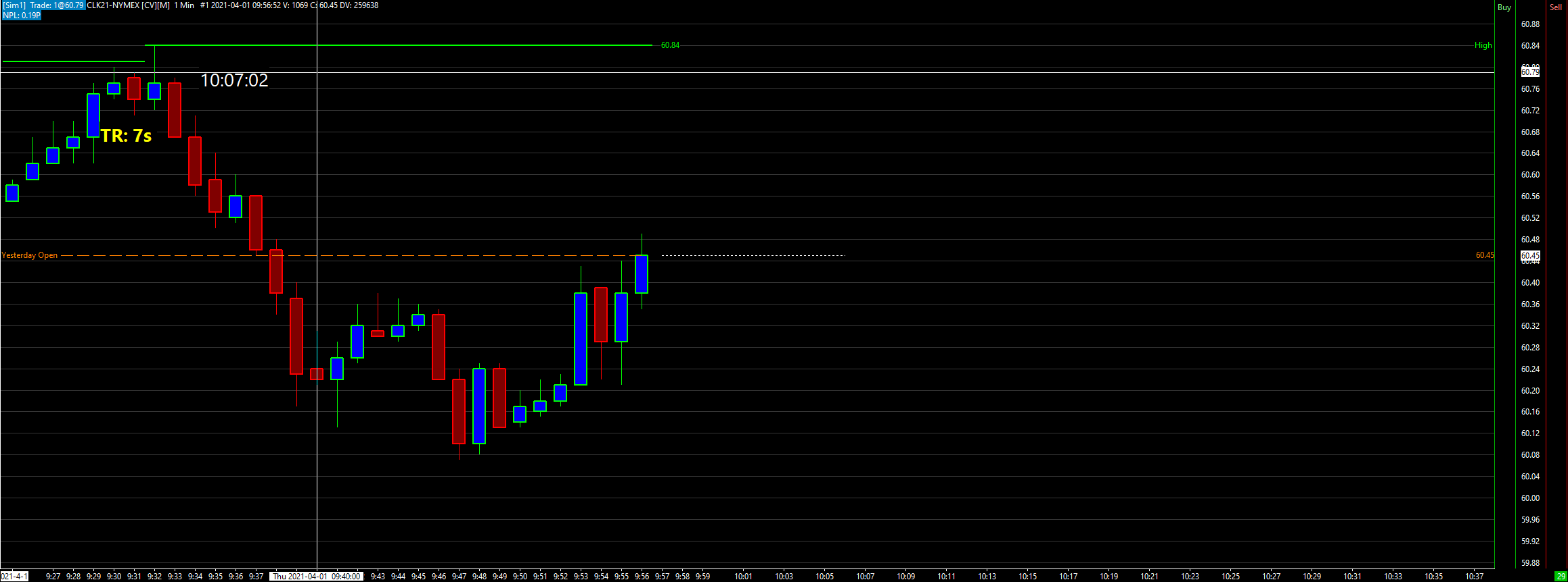

Charts are exactly 10 minutes slow from set and synchronized time on computer and Clock
View Count: 1001
[2021-04-01 14:13:24]
User826383 - Posts: 17
My computer is synchronized and chart showing "Clock real time" study agree with computer clock, but charts are exactly 10 minutes behind. What am I doing wrong?
http://www.sierrachart.com/image.php?Image=1617286024666.png
imageChart and time not in synch.PNG / V - Attached On 2021-04-01 14:05:24 UTC - Size: 50.92 KB - 334 views
[2021-04-01 15:10:40]
John - SC Support - Posts: 48440
You have signed up for the Non-Professional CME exchanges, which means that you need to connect to your live, funded futures trading account at the beginning of each month to qualify for the lower-priced exchange fees. You have not connected to your trading account yet this month. Refer to the following:

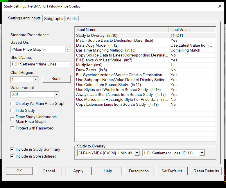

Study/Price Overlay
I am trying to add oil price settlement time lines from a 1 minute chart to a 60 minute chart but the source chart (1Min) changes to a destination chart (60Min) time frame. I have "match source bars to destination bars" set to Yes but changing it to No still makes source bars chart (1Min) change to a 60 minute chart. I have used this previously for many years but now it doesn't work properly for me. What am I doing wrong?
imageStudy Price Overlay settings.PNG / V - Attached On 2023-12-09 03:49:05 UTC - Size: 46.81 KB - 242 views
[2023-12-11 14:49:19]
There is something else that is causing the Bar Period of the 1 minute chart to change. Either the charts are setup to be linked or another study is causing the change. Refer to the following:
Chart Settings: Linking
Unable to Change the Bar Time Period for Charts: Chart Being Referenced by Another Chart Preventing Bar Time Period Change
