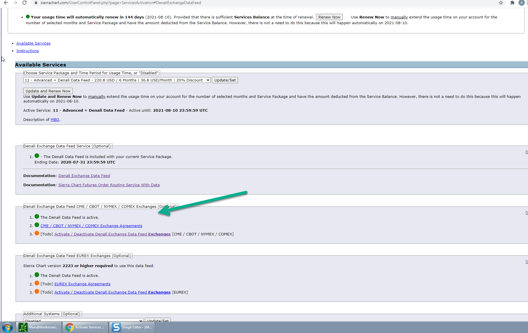

flowtra8r - Posts: 10
I have same account. I see I have the Denali fee
imagedenali.png / V - Attached On 2021-03-19 17:27:53 UTC - Size: 130.46 KB - 303 views
imagedenali.png / V - Attached On 2021-03-19 17:28:00 UTC - Size: 130.46 KB - 306 views
[2021-03-19 17:36:27]
You do have it now that you have changed to Package 11. When you were on Package 5, you did not have the data feed.
The reason you are not getting real-time data from the CME Group of exchanges is that you activated the Non-Professional exchange fees, but you have not verified that you have a live, funded, futures trading account, which the CME needs in order to allow you data at the lower priced fees.
Refer to the following for instructions on how to connect once a month to your *live funded* trading account to qualify for the lower-priced exchange fees:
If you do not have a funded trading account or one with a supported trading service, then refer to this solution:
Easy Solution to CME Funded Trading Account Requirement
We recommend using the above solution in any case to avoid this problem in the future.
