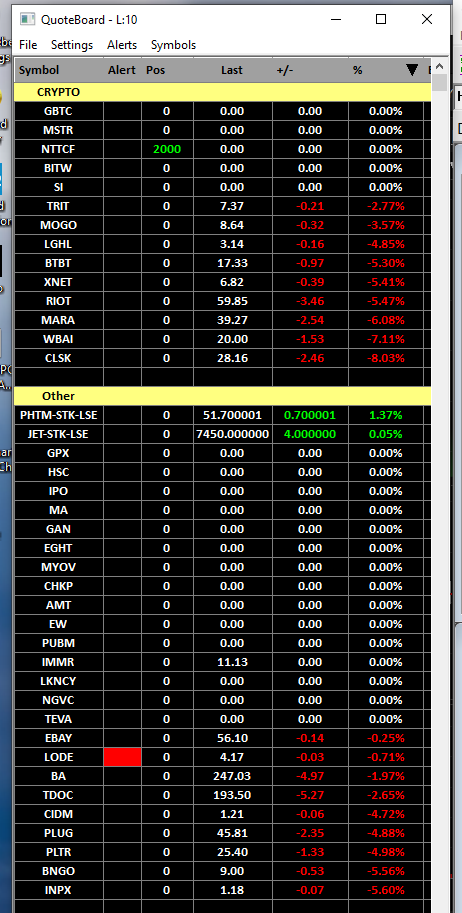

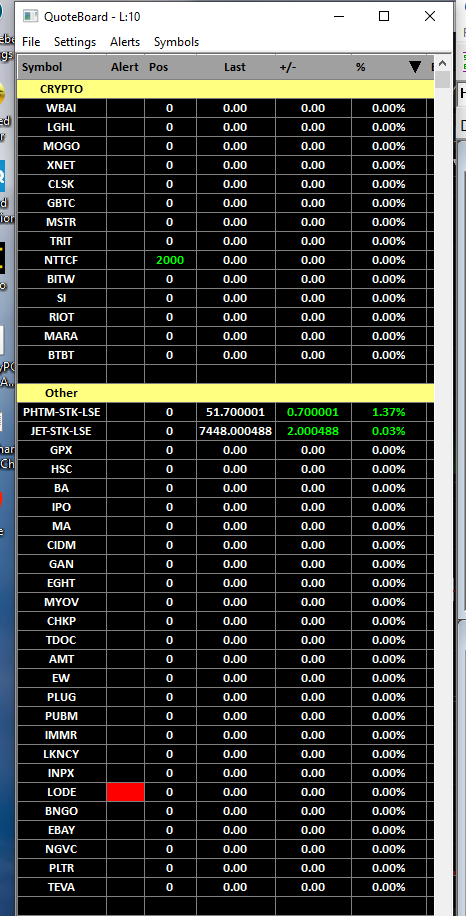

User63042 - Posts: 21
Non of the symbols are updating (apart from UK which are probably coming from IB since I cannot get any UK prices from SC).
Attached is a screen shot with SC real time turned on and one with IB only. You can see that there are no prices with SC but there are when I turn off SC and just have IB.
To get it to work after starting up I have to switch off SC support, disconnect data feed, reconnect with IB only then I can turn SC back on. This seems to be working just now.
BTW - I am a huge fan of SC and have been for over 10 years. Tried other charting packages but just cannot beat SC on charting, TPO and VP.
imageQB with SC and IB 120321 0922 GMT.PNG / V - Attached On 2021-03-12 09:30:07 UTC - Size: 65.43 KB - 306 views
imageQB IB Only 120321 0922 GMT.PNG / V - Attached On 2021-03-12 09:30:21 UTC - Size: 66.25 KB - 337 views
