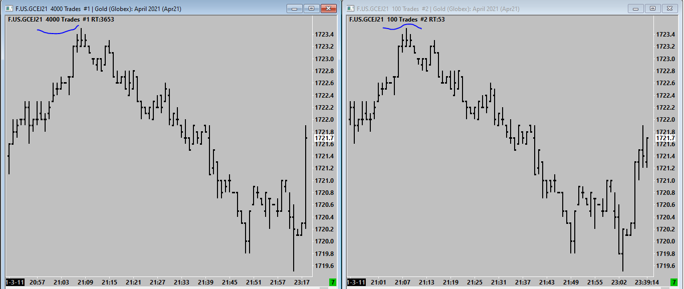

Im trying to use the "Number of trades per bar" chart but its not working properly
I attached a picture to make it clear... 4000 trades (left) and 100 trades (right) - both charts looks the same, but ofc they should look different as the number of trades are not the same
I noticied that the tick chart seems looks about the same as the previous chart that it was made off... so if you make it off 1 min chart it ill look like the 1 min chart, if make it off 1 hour it ill look like the hourly and so on...

[2021-03-12 02:42:12]
We are no longer as of December 28, 2020 providing the Sierra Chart provided historical data service for CQG or Interactive Brokers users. For more information, refer to this Support Board thread:
Jan 1, 2021 Changes to Historical Data: Interactive Brokers, CQG
Also refer to this post for steps that you need to do now:
Jan 1, 2021 Changes to Historical Data: Interactive Brokers, CQG | Post: 245144
The solution to this problem is to use the Denali Exchange Data Feed for CME and EUREX data. Step-by-step instructions are here:
Let us know if you need help with the set up and we will help you through all of the steps.
In the case of CQG you will then need to contact your broker and cancel CME and EUREX exchange fees through your CQG account so you do not pay exchange fees twice. You definitively do not have to pay any market data exchange fees through your brokerage account to CQG. This is not required.
For other exchanges (ICE, HKFE) you need to use the Sierra Chart Exchange Data Feed:
As an alternative to CQG, we recommend using the Sierra Chart Order Routing Service:
Sierra Chart / Trading Technologies Futures Order Routing Service
In regards to using CQG provided historical data, we definitely do not recommend using that. It has an additional cost of 25 USD per month. The data delivery is slow and inefficient and causes Sierra Chart to freeze during the processing of it. Only 5 days of tick data is supported from CQG. And only current futures contracts are provided.
Whereas with Sierra Chart provided data feeds, you will have access to 10+ years of reliable high-speed delivered tick by tick data. Once again we do not advise using CQG historical data and it will not work well with Sierra Chart. And we also provide no technical help or support for any CQG provided historical data or real-time data.
