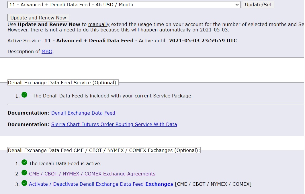

[2021-04-14 07:22:57]
Пользователь488020 - Posts: 100
Hello, I connected three charts with one login and password on one computer. All programs are running. But I don't have the data. why? How to fix it? I was faced with the fact that only two sierra charts are launched on one computer, there is no data on the third program, or then all three will stall! Is that right?
imagequestion to support.jpg / V - Attached On 2021-04-14 07:22:43 UTC - Size: 370.38 KB - 295 views
[2021-04-14 13:53:33]
One of the problems you have is that you have not filled out the Exchange Agreements correctly. In order to qualify for the non-professional exchange fees, you need to have a futures trading account, and we need to know who that account is with and the account number in the Uniform Subscriber Agreement. Without this, you will be considered a professional and have to pay for the professional exchanges.
You can access the agreements on this page:
https://www.sierrachart.com/UserControlPanel.php?page=ExchangeAgreements
If you do not have a futures trading account, then we recommend the following service:
Easy Solution to CME Funded Trading Account Requirement

[2021-04-14 17:47:27]
First, you have not filled out the Exchange Agreements correctly. Yes, you filled them out, but they were rejected because you did not have your trading account information. You will see all of this on this page:
Please fill out the agreements again and make sure you put in your Broker/FCM and your Account Number.
Second, you are only setup to receive the data on one computer at a time. Refer to the following:
Denali Exchange Data Feed: Connections
[2021-04-14 18:55:43]
