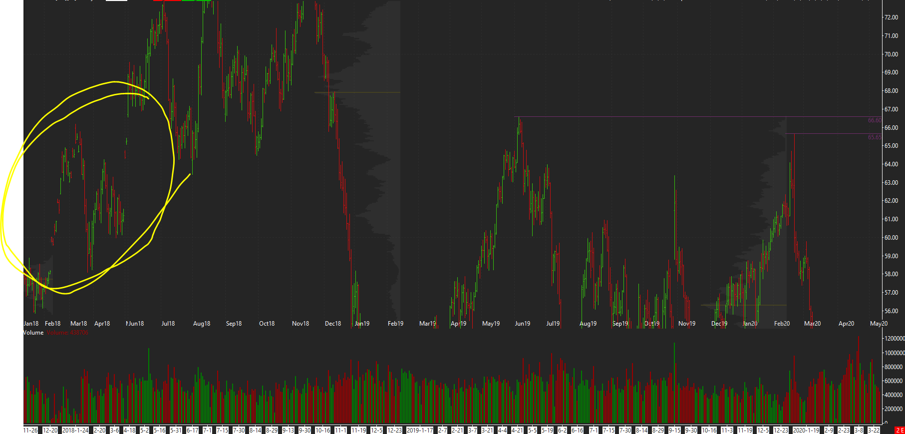

There are weeks of data missing from my ES and CL daily charts which ends up displaying as gaps. The charts are intraday charts, but are set on the daily timeframe. I recently switched over from TT routing to CQG and that is when the issue occurred. I am using Denali data feed with CQG routing using AMP. Attached is a photo of a daily chart of crude oil. I tried reloading and recalculating, but that did not work. The symbols are already translated as well.

[2021-03-08 16:46:35]
Check to make sure that the option for File >> Data/Trade Service Settings >> Common Settings >> Allow Support for Sierra Chart Data Feeds is set to Yes and that you have an [M] showing after the symbol name in the Chart Header. This will tell us if you are getting the data from the Denali Exchange Data Feed.
If you have the [M] showing, then follow these instructions to re-download the data:
[2021-03-08 17:45:09]
mnill - Posts: 37
Okay, my charts do have the [M]. I tried deleting and re-downloading and after it finished the chart still has the same gaps present.
[2021-03-08 18:18:56]
Since this appears to be a Continuous Futures Contract chart, you need to follow these instructions:
