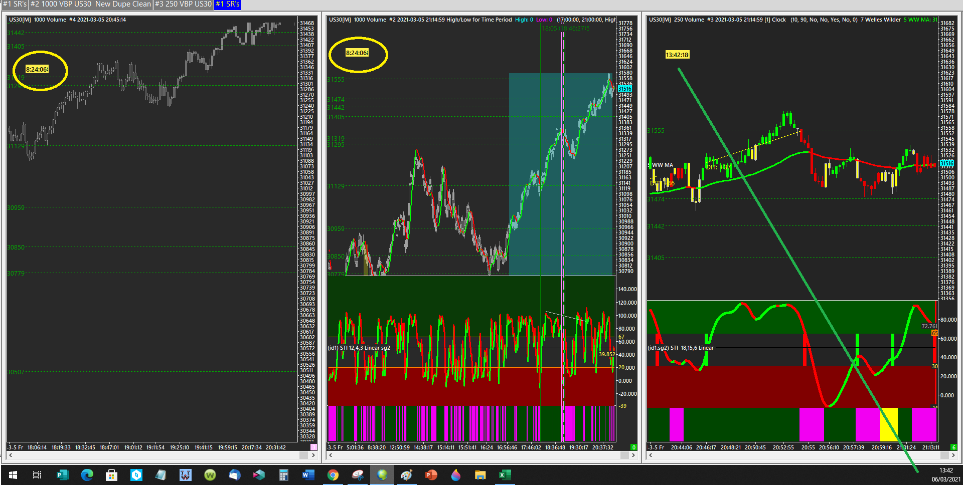

I have 3 charts that I normally have the Real Time Clock upon. I have REMOVED the clock from 2 of the 3 charts but it continues to display and is Frozen in time. My STUDIES field does not show the Clock at all - See attached files. How do I remove this?? (This is an error that occurs now and then and has done over last few years and is generally only removed by rebuilding the chart). Thanks - Mark B See attached files

[2021-03-06 16:45:45]
Remove it through the Manage Chart Drawings window:
Chart Drawing Tools: Manage Chart Drawings

Hello Sierra - are you sure? Because the 'Tools > Manage Drawings' does not include the Real Time Clock or any other STUDY like MACD's, it is a tool for editing deleting lines etc. I tried adding a clock to another chart to prove the point - It does not work. Next suggestion please
[2021-03-07 17:19:09]
Yes we are sure, and we added the Clock-Realtime study to the chart and then went to the Manage Chart Drawings Window and we do see the text drawing listed there.
