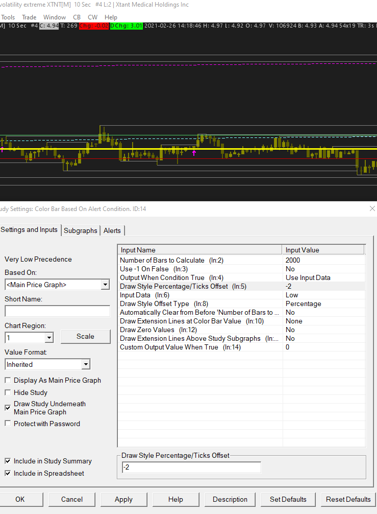

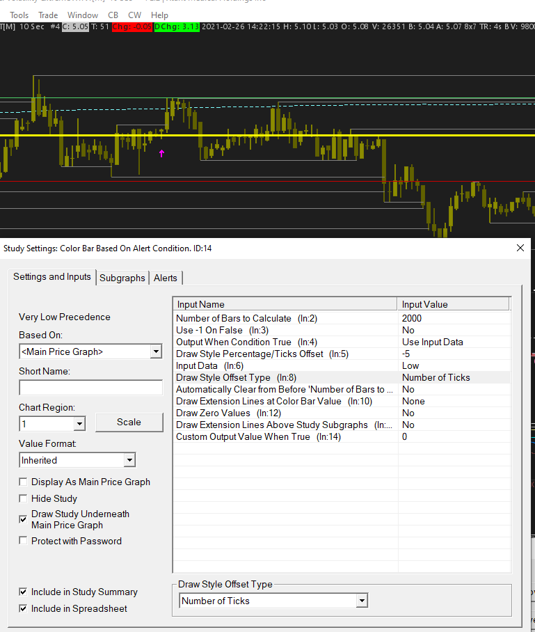

I have the last version of sierra chart.
Just found out how plot arrows.
Now i really want to have some offset in % but it just wont work.
it work ok in TICK
thanks in advance.

It does work properly. What you need to consider is that the Percentage is based on the price. In this case, you have a chart that has prices about 5.00, so 5% of 5.00 = 0.25, so the arrow would be placed at ~4.75.
You just need to use a larger percentage, or stick with the # of ticks. # of ticks overall works better as the arrows tend to stay in a better position while changing scale.
