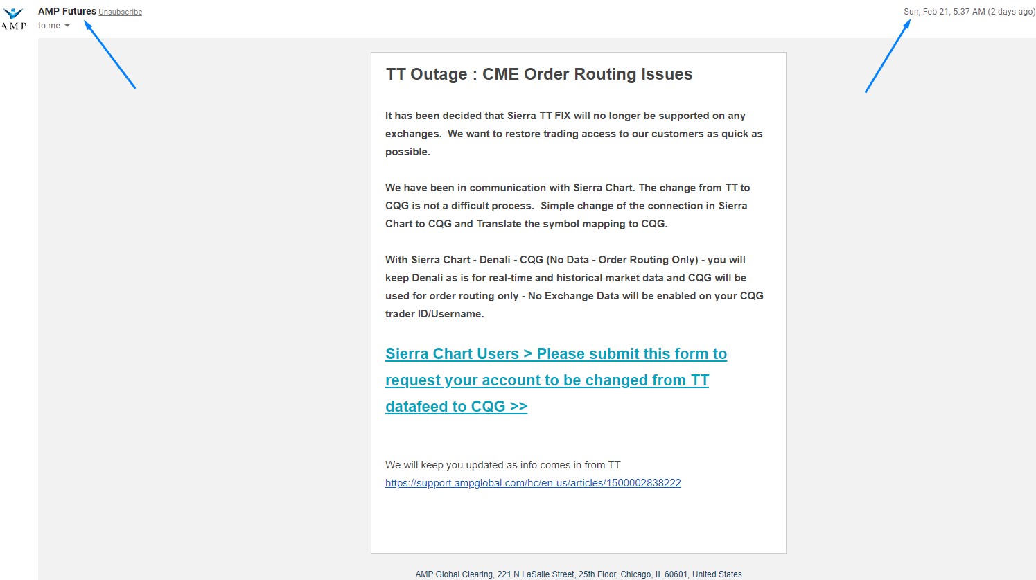

Has the TT issue been resolved? What is the correct configuration to use Denali with Dorman?
Date Time Of Last Edit: 2021-02-23 12:33:07
imageAMP Futures (2-21-21).jpg / V - Attached On 2021-02-23 12:33:01 UTC - Size: 128.46 KB - 383 views

[2021-02-23 12:29:00]
User94606 - Posts: 327
You are saying that the connectivity with Denali and Dorman is back to normal but I received an email from AMP Futures on Feb 21, 2021 asking their customers to switch to CQG.
So, I have an account on both CQG and Dorman. If I continue with Denali as is, can I access Dorman and AMP Futures? Can you please clarify?
Date Time Of Last Edit: 2021-02-23 12:34:14
imageAMP Futures (2-21-21).jpg / V - Attached On 2021-02-23 12:34:04 UTC - Size: 128.46 KB - 353 views
[2021-02-23 13:21:35]
Yes.
In the case of AMP, you need to have a separate installation of Sierra Chart to use with CQG:
Using Multiple Data and Trading Services at the Same Time: Introduction
Both of them can use the Denali data feed.

Is the AMP scenario using CQG, is that temporary or permanent? Please confirm If I use my Denali with Dorman now, I will not be able to access my AMP account then unless a create a separate install for CQQ - correct?
[2021-02-23 16:02:30]
John - SC Support - Posts: 48355
We have been told that the stopping of support for TT with AMP is permanent.
If you want to access both your Dorman account and AMP account, it is best to have two separate installations. As long as these are on the same computer, you do not need to pay any additional fees and you can get the Denali data to both installations at the same time.
