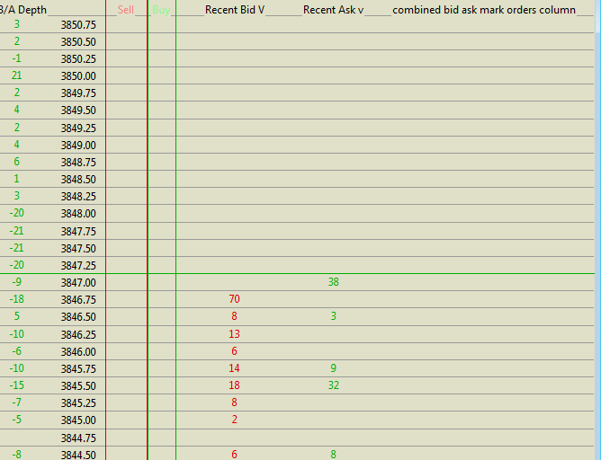

Trader8188 - Posts: 20
https://postimg.cc/xkbfhhMQ
I followed instructions that were provided to view MBO data for the trading chart DOM. So far no MBO data coming through and the bid volume column is red.
Does anyone know how I can best configure this? Would be grateful if anyone can share their settings with me.
Symbol: F.US.EPU21
[2021-07-12 04:00:01]
Market by order data in Sierra Chart require Service Package 12.
