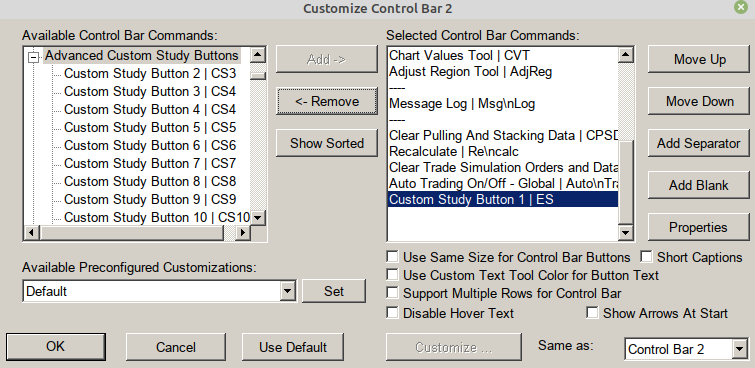

I'm trying to add a button to the menu which enables or disables (yes/no) a selection in a study. Does anyone know how to do this with ACSIL?
I've been able to get the following code to enable or disable a study, however, when I try to add a second button, the two buttons get linked/combined so they toggle back and forth rather than independently working. I used different variables for the second button but they were still combined when toggled.
This comes from the study: AutomatedTradeManagementBySubgraph.cpp
Does anyone know how to add a button for anything other than enabling/disabling a study?
The button on the far right (ES) of the first image works to enable or disable the ES study. I also want to have another button to enable/disable longs. The second image is where you add the button to the control menu.
This is all done through the customize control bar options.

imageScreenshot from 2021-01-24 22-36-40.png / V - Attached On 2021-01-25 03:37:14 UTC - Size: 18.11 KB - 798 views
imageScreenshot from 2021-01-24 22-40-00.png / V - Attached On 2021-01-25 03:40:18 UTC - Size: 67.44 KB - 829 views

Here is an example of menu button toggling.
1) Under global settings, add a customized control bar
2) Right mouse click on the control bar
3) Scroll to Advanced custom study buttons
4) Click on a button and add it to the control bar
5) Note the button number and enter this in the example study input (you can have a max of 150 buttons)
6) Once added, you can change the properties of the button...select it, the properties and you will see all the options.
