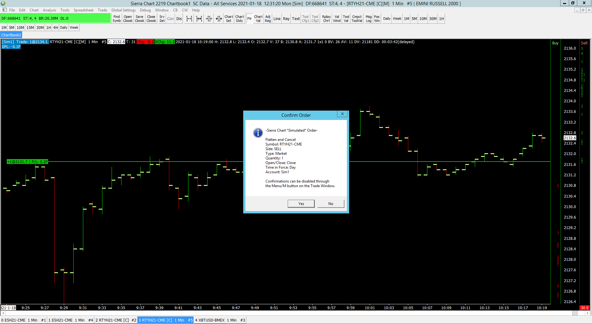

We have attached an image showing the confirmation window when we are trying to Flatten a position. When this window is up, we are not able to exit from Sierra Chart (or perform any other action other than responding to this window).
Please look at the image and let us know that you also have a similar window up, and while it is displayed, you are able to select the X in the upper right corner and then exit from Sierra Chart.
imageFlattenConfirmation.png / V - Attached On 2021-01-18 18:34:19 UTC - Size: 53.82 KB - 363 views
[2021-01-18 18:49:03]
GreyLock58 - Posts: 173
Yes, I have no problem with simulation. I cannot close Sierra Charts until I click on the confirmation window. The problem is with live trading and with the "Flatten All" button via the Trade Positions. With live trading and clicking on the "All Flatten" button via the Trade Positions window I can close the Sierra Charts without clicking on the confirmation window. Positions with simulated trading does not show up in the Trade Positions window. This problem can only be duplicated with live trading.
