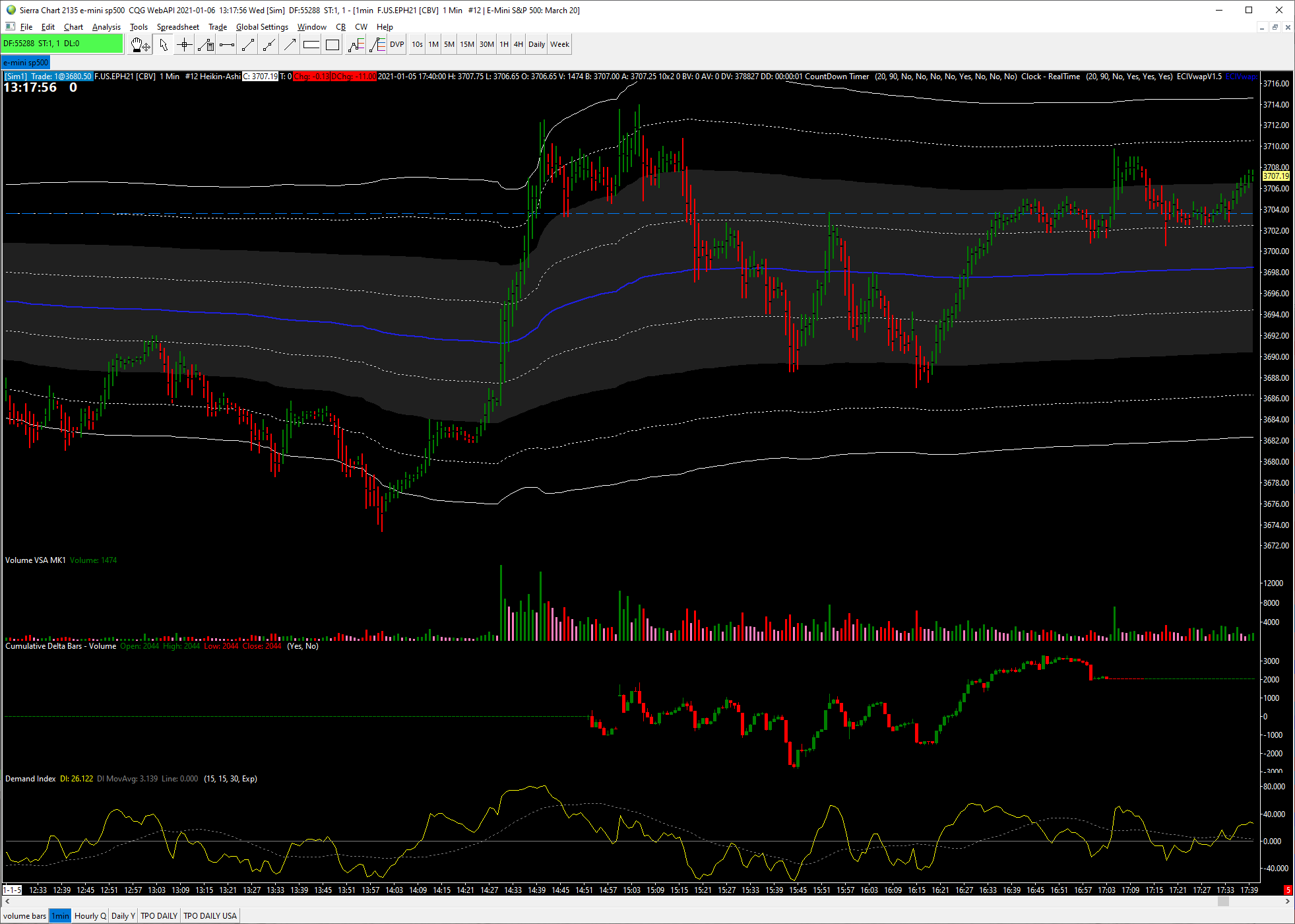

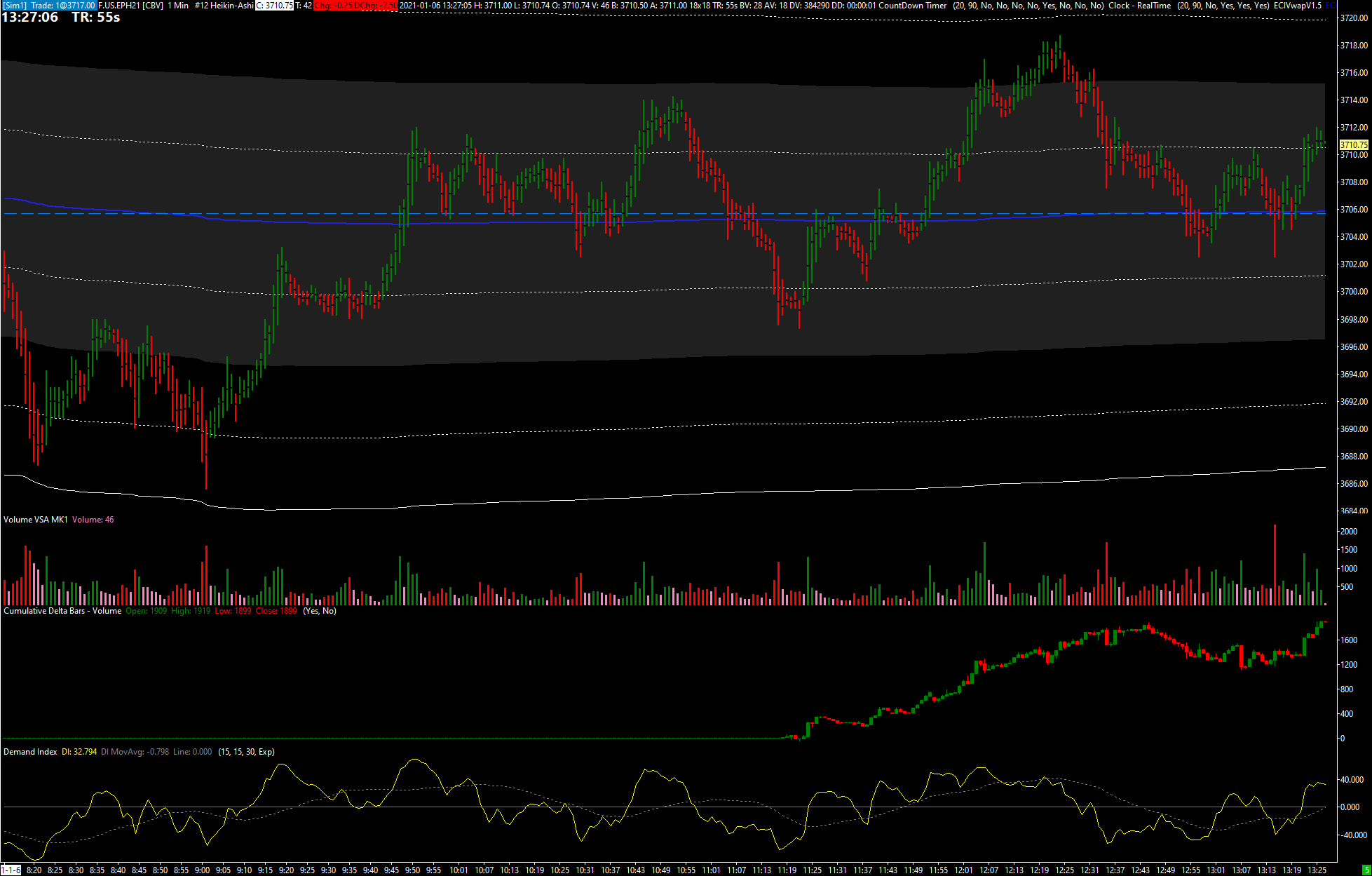

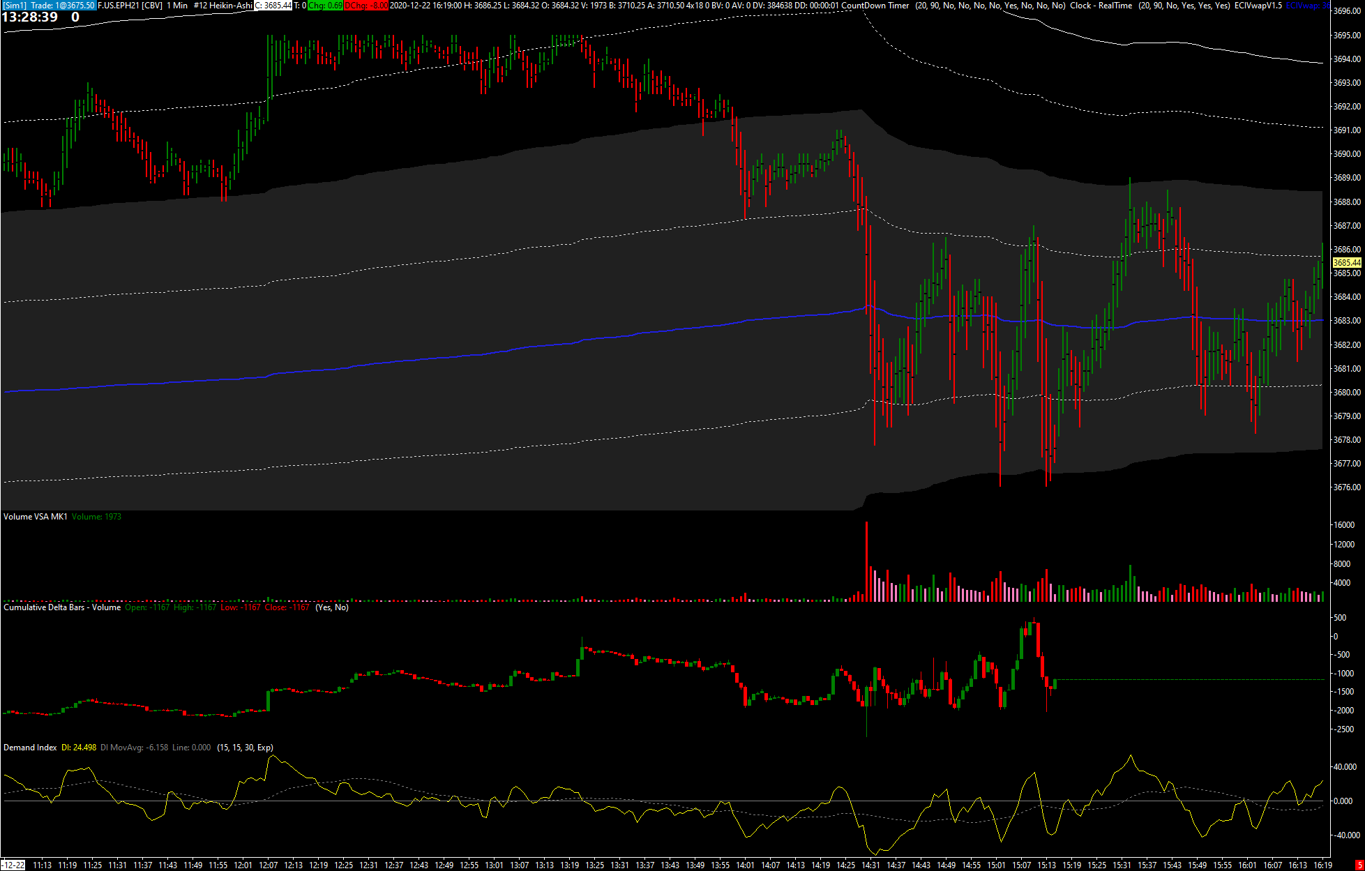

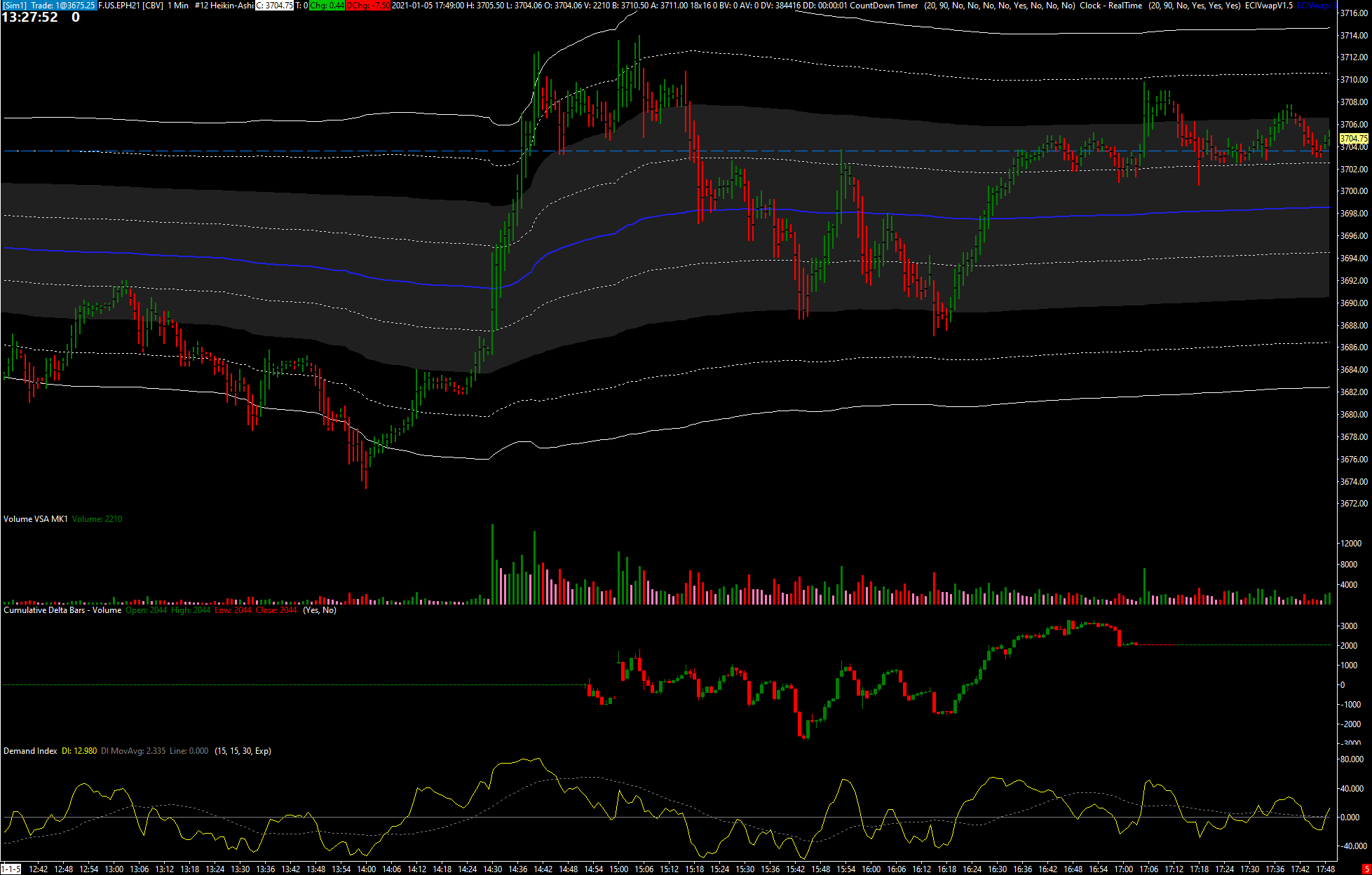

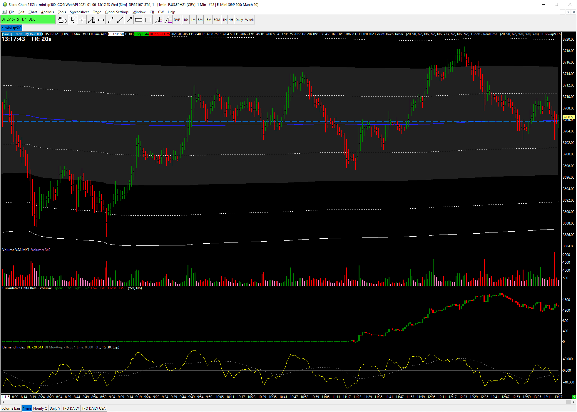

hello,
From 22nd Dec 2020 my cumulative delta bars study stopped working properly. It only works when I use platform otherwise it shows flat line, when it switch platform off for a while it'll show flat line again until i turn it on....I am attaching screens how it looks line from 22nd december 2020 yesterday and today.
06.01 -> http://www.sierrachart.com/image.php?Image=1609939625787.png
yesterday -> http://www.sierrachart.com/image.php?Image=160993967124.png
22.12.2020 when it stopped working -> http://www.sierrachart.com/image.php?Image=1609939719852.png
until 22nd december it's all fine.
