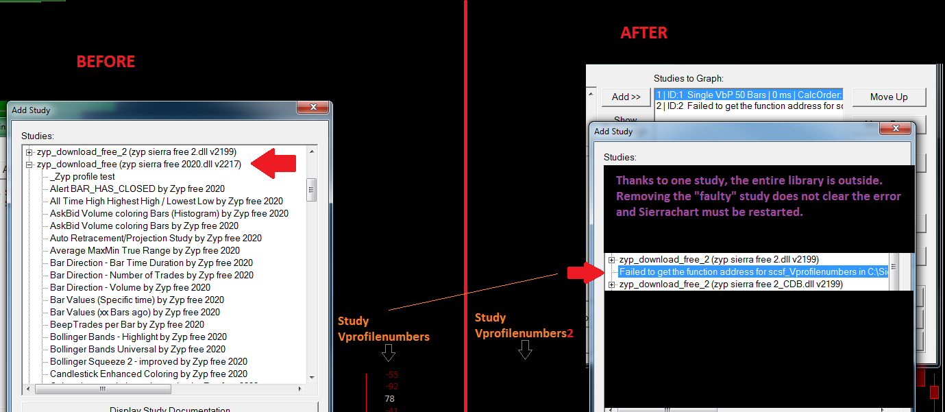

[2021-01-31 01:28:03]
Ackin - Posts: 1865
Since starting a new DLL Loading Management, another strange thing appears.
SC: You know for sure because it was one of the bugs in the lower version of Sierrachart. (scsf_OneTimeFraming in C:\SierraChart\Data\SierraChartStudies.dll. Error: Windows error code 127)
So it's more of a warning to other developers.
If you distributed a library to someone and then rename it scsf_xxxxxx to another name (or delete the study), after uploading a new version of the library, the entire library will be disabled for the end user. Error 127 is reported to him, but even after removing the study from the chart, the library no longer appears in the list, the library must be reloaded, or better for laymen, save chart without a faulty study and restart Sierrachart. Then the library will be loaded correctly.
[2021-01-31 01:56:21]
Regarding post #36 this does not make sense to us at all. We need very very specific details of filenames and precisely exactly what you are doing step-by-step. You are making a sound as though there is something wrong. That is just not the case at all.
We are certain, there is no problem at all and there is just something else going on or a misinterpretation.
Date Time Of Last Edit: 2021-01-31 01:56:57
[2021-01-31 03:03:44]
Ackin - Posts: 1865
You are making a sound as though there is something wrong. That is just not the case at all.............We are certain, there is no problem at all and there is just something else
Guys.....I like your program. After all, we all just try to make everything work without any surprises. Nothing more....
Take a look at the attachment ... In earlier versions of Sierrachart, if a study in the library was deleted but someone already used it in the chart it appeared at the end of the list of all studies as non-existent .... Now the whole library has gone ....
It doesn't limit me when I know it, I wrote it above for others (or for you if you're interested about it)
Compiled for ver 2217 but tested 2217,2220,2222,2225
Date Time Of Last Edit: 2021-01-31 13:05:55
imageLibrary Issue.png / V - Attached On 2021-01-31 03:04:04 UTC - Size: 106.1 KB - 1041 views
[2021-01-31 11:30:16]
We cannot reproduce any problem like this and we do not have any clear instructions from you.
[2021-01-31 11:37:37]
Ackin - Posts: 1865
step-by-step
1) Create a .CPP file
2) Insert into this file, for example, the ATR study + the MACD study
3) Recompile the library (.DLL)
4) Run the Sierrachart higher than ver2217
5) Create / open a chart
6) Use the ATR study from .DLL in this chart
7) Save the chart file
8) Close the Sierrachart
9) Remove the ATR study from the source code (.CPP)
10) Recompile the library (.DLL)
11) Run the Sierrachart
12) Open the chart with the ATR study inside (created in steps 5 and 6)
13) In the List of libraries ***, the library (in which the ATR study was located before the removing) is missing and the MACD study cannot be used
14) There is a line: "Error: Windows 127 error code"...This is applied to the whole library and other studies from this (.DLL) are invisible
*** List of libraries = The list from Menu >> Analysis >> Studies >> Add Custom Study
Date Time Of Last Edit: 2021-01-31 13:02:42
[2021-02-01 10:37:18]
There is no need for a restart to reproduce this. It really relates to removing the very first study from a Custom Studies DLL, which is also used on a chart.
This is resolved in version 2226.
