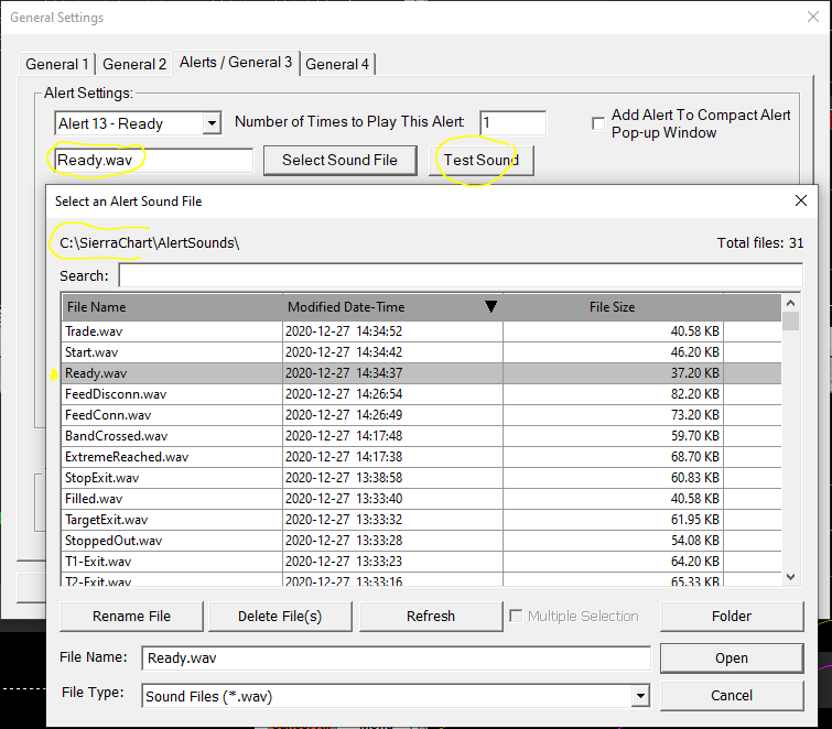

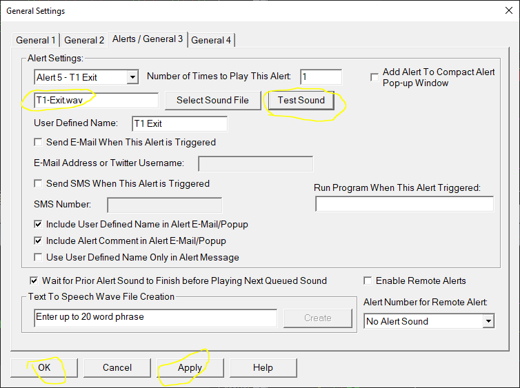

After following the directions in the Alert Sound Settings of the online help guide, I cannot get custom alert sounds to take. Despite [selecting sound file] and having it appear properly, whenever I press [test sound] the single ding plays instead; the same happens when I trigger the alert. I've restarted SC several times, in case that was the problem. No matter what I do, when I press [test sound] the new sound will not play... I get a ding instead. Please see attached (it is not a chart image - it's a window image).

[2020-12-27 22:27:19]
The file name that you have highlighted in that screenshot, what is the exact folder path that it is located within?
It should be C:\SierraChart\AlertSounds

The custom sound files are in the default C:\SierraChart\AlertSounds directory. I am able to play them with Windows Media Player. However, when I click your [test sound] button I get what sounds like a Windows Error chime. I'm attaching more detailed screen shots, showing the path. Is it possible that some .wav files are not compatible with your playback mechanism? I used this online tool to create them...

imagealerts.PNG / V - Attached On 2020-12-27 22:47:07 UTC - Size: 43.84 KB - 317 views
imageReady.PNG / V - Attached On 2020-12-27 22:47:15 UTC - Size: 19.82 KB - 344 views
