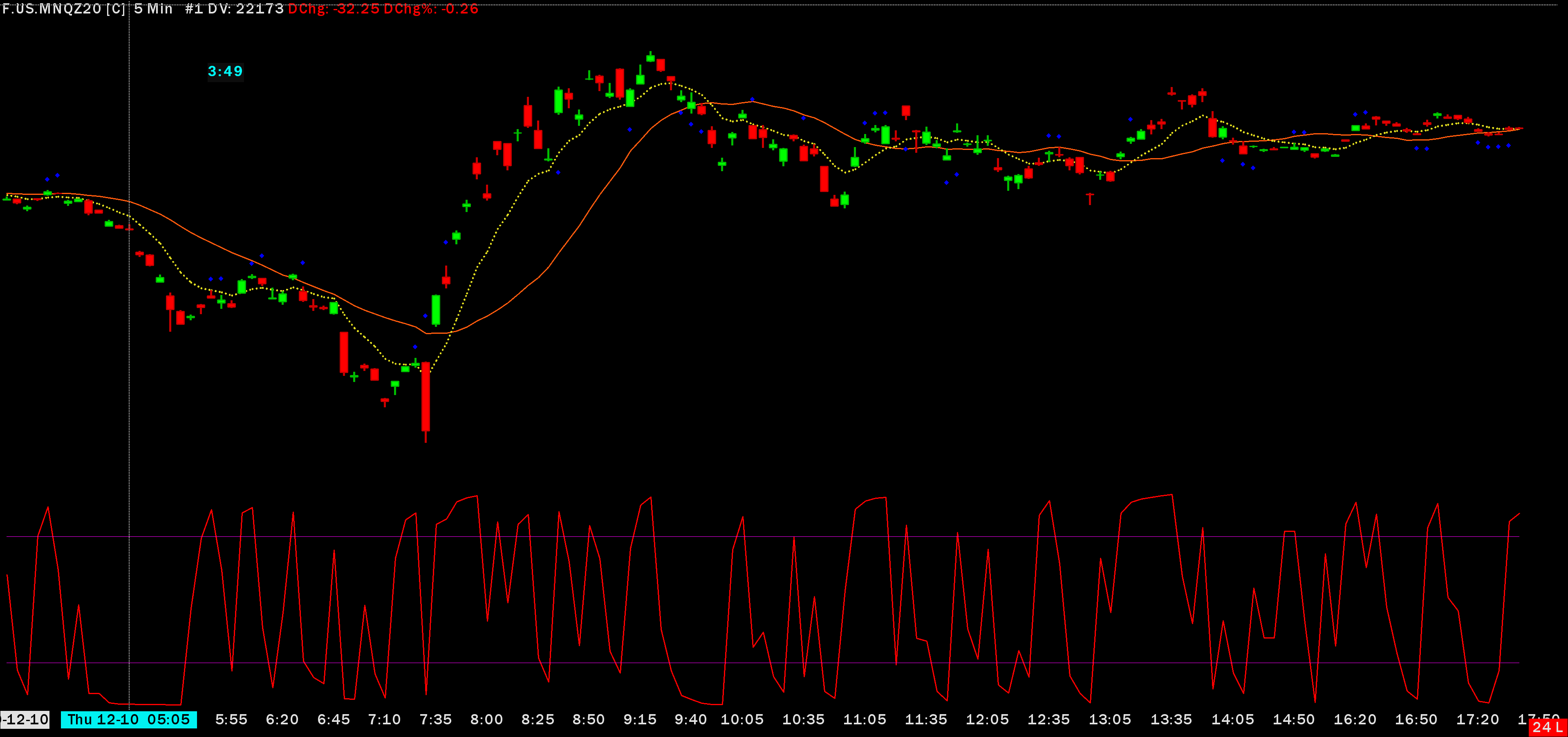

AM I MISSING SOMETHING OR IS THIS NOT POSSIBLE? I'M SIMPLY TRYING TO OVERLAY 1MIN BARS ON
A 5MIN CHART(WITH CORRESPONDING 5MIN. STUDIES) AND I'M GETTING SHIT(I'LL ATTACH A PIC)OF THE BEST I CAN DO.(BARS HAVE GAPS,(NOT1MIN BARS)
NO PROBLEM GETTING THE 5MIN. ALGOS OVER ON THE 1MIN CHART BUT(AS A MATTER OF PREFERENCE IT FEELS DIFFERENT LOOKS DIFFERENT IN THE SCALING, FOR ME. I CAN GET 1MIN. STUDIES TO OVERLAY BUT NOT THE ACTUAL BARS???!!!

We think the issue you are having is that you are not understanding that it is only going to use one bar from the 1 minute chart and overlay that single bar into the 5 minute slot. As to which bar it uses is dependent on your settings for the Study/Price Overlay. For instance, if you have the option for Data Copy Mode set to Use Earliest Value from Corresponding Timeframe in Source Chart, then when you look at the bar for 07:40 in the 5 minute chart, it is going to show you the 1 minute bar from 07:40. Whereas, if you had the Input set to Use Latest Value from Corresponding Timeframe in Source Chart, then it would be displaying the 07:44 bar from the 1 minute chart at 07:40 on the 5 minute chart.
All of this is explained in the documentation for the Study/Price Overlay here:
Study/Price Overlay Study
