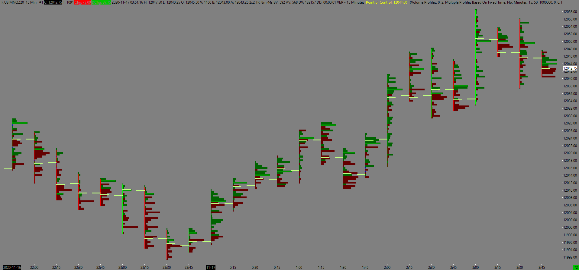

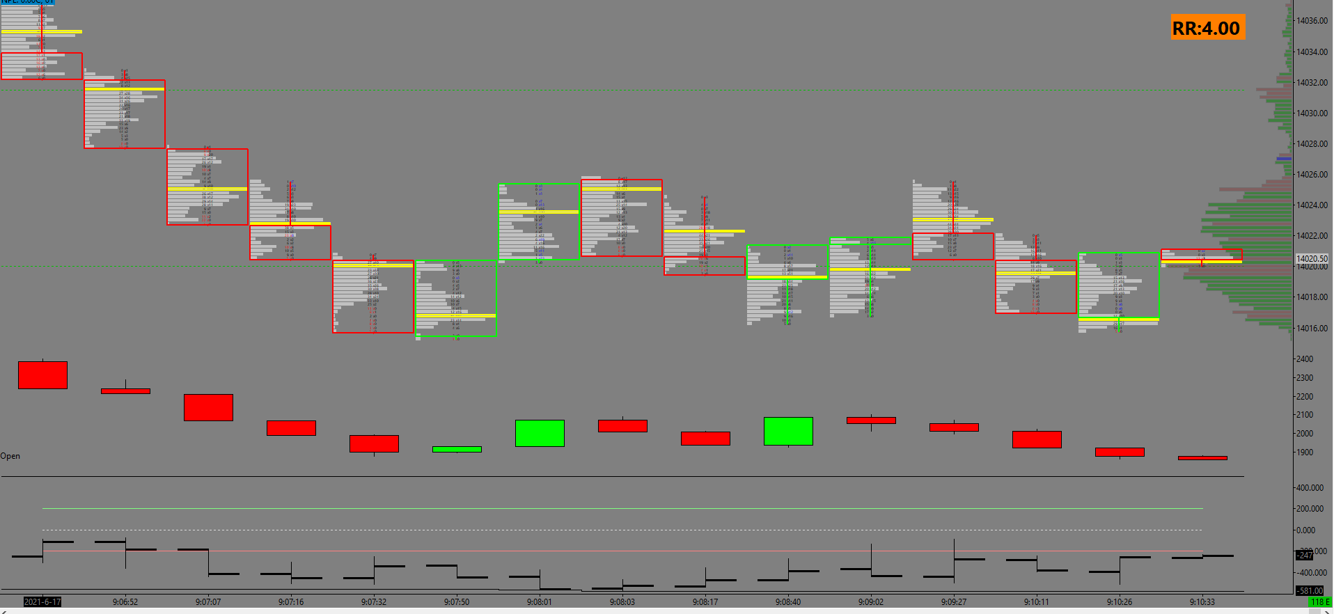

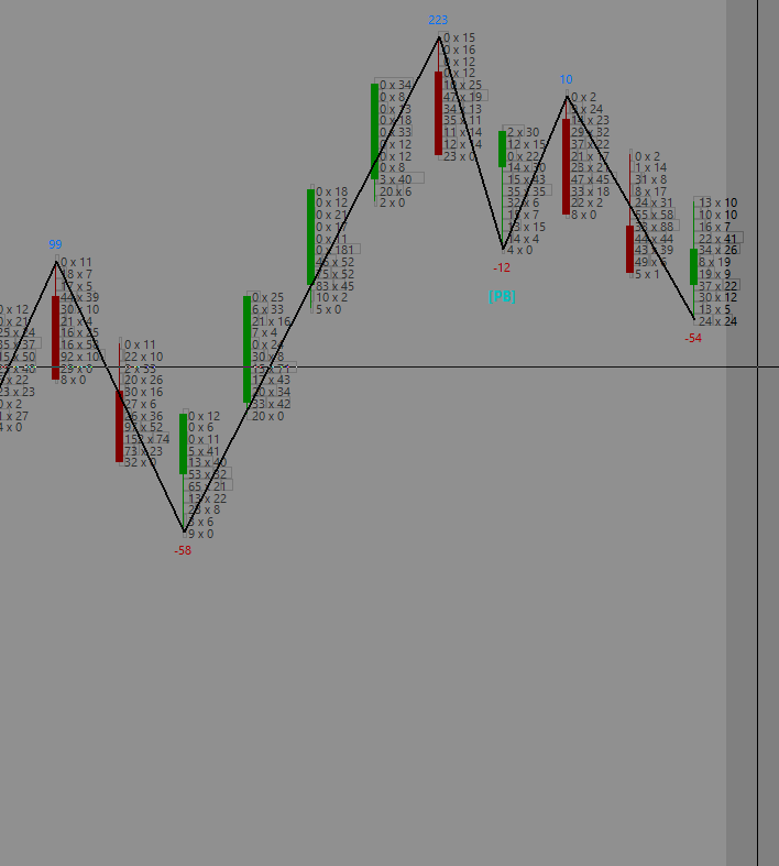

Im trying to configure my chart to display the volume in numbers like the attached pic.(has the text written on chart with levels) im currently stuck with the chart that has the histograms on the bars with the red green sticking out of them. it was done on Package 3, theyre both my charts.

The attached picture with the written text is using a Numbers Bars study. You are using the Volume by Price study.
The Numbers Bars study requires Package 5 to be able to use it. Refer to the documentation here for the Numbers Bars:
Numbers Bars
But, if you just want basic numbers, you can still get those in your VbP, just set the Input for Draw Volume in Bars to the particular item you want. Refer to the information here:
Volume By Price Study: Display Volume in Bars

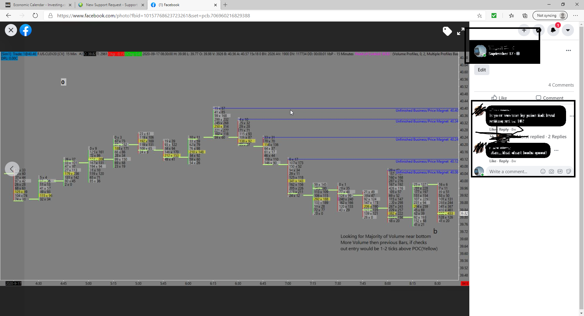

Im using the Numbers Bar Study, how do I remove the #'s so it just show the Gray Volume horizontal bars in the candle and also when theres a Imbalance I want the Imbalance to be the color of the Aggressive traders, so instead of a Gray Volume bar at that price level it will be the color of Red(Sell Imbalance) or Green(Buy Imbalance). I included attached pics

To remove the numbers, set the Column # Numbers Bars Text to No Text. Refer to the following:
Numbers Bars: Column # Numbers Bars Text
To get a specific color when there is a particular imbalance, you would need to set your Percent Compare Thresholds to the values you want where the highest value would be the imbalance you want. Then set the color for that range to what you want. Refer to the following:
Numbers Bars: Column # Percent Compare Thresholds
And also the following:
Numbers Bars: Column # Range 3 Up Color

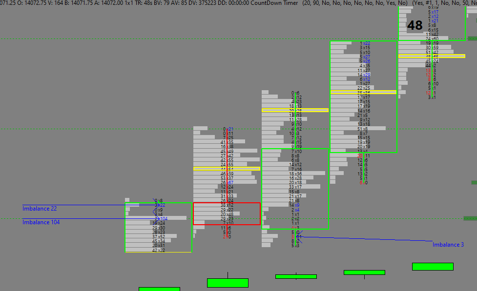

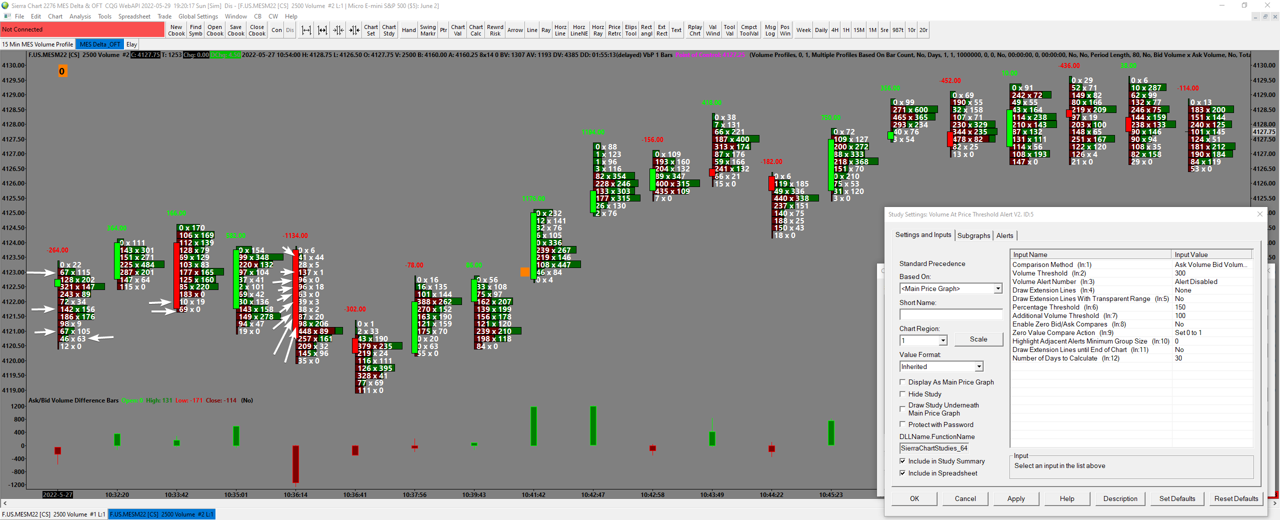

Im using the VbP study with the VbP Threshold Alert2 study, i included a pic to show the current study settings for it and also on the candlestick I drew arrows of where there should be a highlight to show the imbalance(300%)

What is your Comparison Method set to?
Also, you point to a few comparisons that have zeros, therefore you would want to enable the option for Enable Zero Bid/Ask Compares and then set the Zero Value Compare Action as desired. Refer to the information at the following for these:
Volume at Price Threshold Alert V2
