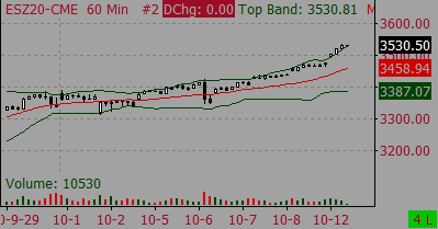

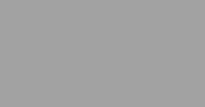

After several attempts at "update symbol from Server" ESZ20-CME "Historical" only is not receiving real time feed ?? The interday is functioning properly
[2020-10-12 16:59:49]
Are all of the charts using this exact same symbol?: ESZ20-CME
[2020-10-12 17:03:52]
User664240 - Posts: 209
yes
http://www.sierrachart.com/image.php?Image=1602522173953.png
http://www.sierrachart.com/image.php?Image=1602522213773.png
