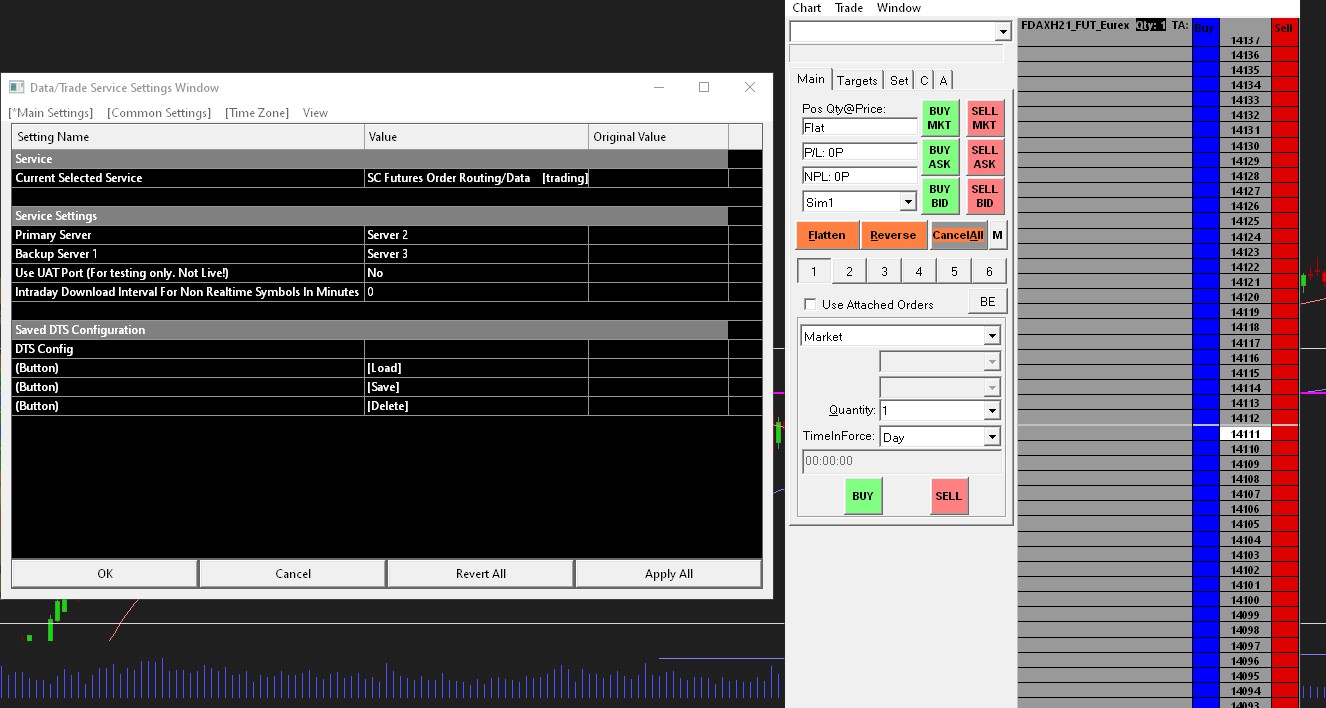

wallstreetsson - Posts: 80
where is the mistake? thanks!
imageScreenshot_3.jpg / V - Attached On 2021-02-16 09:37:52 UTC - Size: 183.26 KB - 417 views
[2021-02-16 09:52:10]
Go to this section:
https://www.sierrachart.com/UserControlPanel.php?page=ServicesActivation#DenaliEUREX
Complete steps two and three:
[Todo] EUREX Exchange Agreements
[Todo] Activate / Deactivate Denali Exchange Data Feed Exchanges [EUREX] (In your case only AMP can do this part. So you need to ask them after you complete the agreements.)
You should also update to 2230:
Date Time Of Last Edit: 2021-02-16 10:03:35
