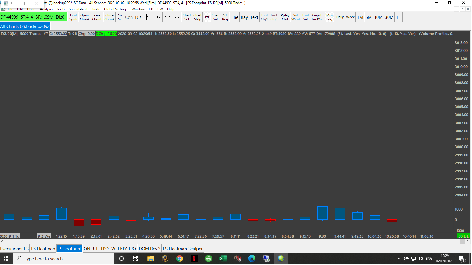

I downloaded a chartbook file from a friend which contains a few charts such as tpo DOM and footprint.
The DOM and the TPO charts work fine however the footprint chart does not load the footprints but it is loading the delta bars at the bottom of the screen.
I was just wondering if there was something I need to enable on chart settings or something.
I attached a screenshot in case its helpful, cheers guys.
http://www.sierrachart.com/image.php?Image=1599039219552.png
imagescreenshot footprint.png / V - Attached On 2020-09-02 09:31:30 UTC - Size: 103.59 KB - 408 views

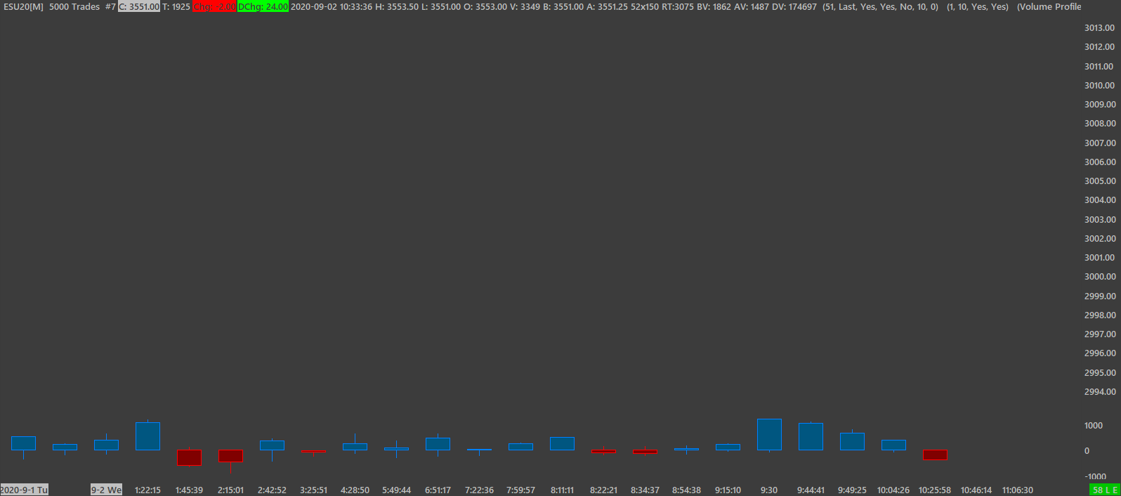

Sorry the issue is obvious to me now, my chart is not adjusting to where price is at for example the price range from top to bottom of my chart on ES is 3534 at the bottom and the top of the chart is 3570.
Current price is somewhere at 3472 thats why I cant see my footprint because my chart is locked between prices 3534 and 3570.
I have tried to fiddle about with it so I didn't have to bother you guys as much but I am still finding my feet with this sierrachart so you'll have to bare with me for now.
How do I make my chart scale accordingly to price moving because it is just moving off my screen.
Thanks guys
[2020-09-04 12:58:26]
John - SC Support - Posts: 48095
Set the price scale to Automatic. Refer to the information here:
Chart Scale and Scale Adjusting: Scale Window
[2020-09-06 10:49:49]
Refer to:
Chart Scale and Scale Adjusting: Chart Bars or Studies Not Completely within View, Not Displayed, or Cut Off. Reset Scales.
