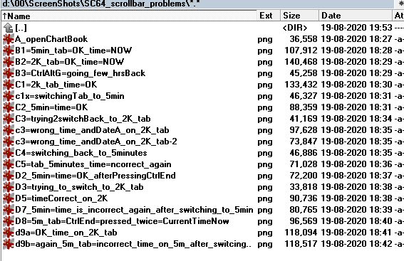

I've attached the Chartbook with ScreenShots
