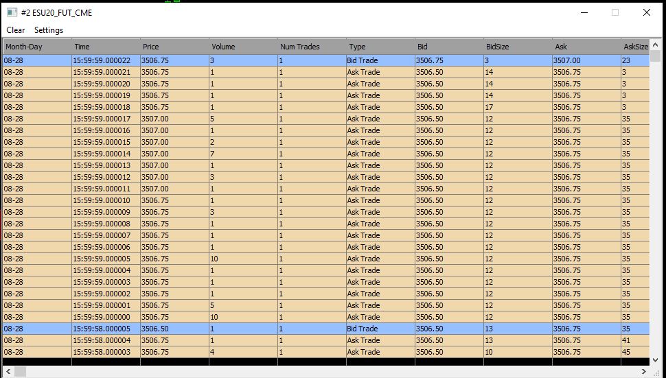

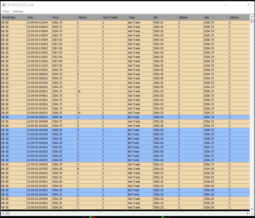

ejtrader - Posts: 689
SC Team - I have version 2159 running one with All Services and one with Futures Order routing.
With All Services - I get true milli/micro second timestamps in T&S data and only a counter based timestamp with Order routing service. What setting I should use to make sure I get true timestamp for the T&S data? Both of them are using Denali feed. Is this data dependent on the server I am connected to or some setting on the client side?
Attached are the T&S data from these 2 sources.
Date Time Of Last Edit: 2020-08-30 00:39:37
imageAllServices_TS_data.JPG / V - Attached On 2020-08-30 00:37:50 UTC - Size: 216.9 KB - 1324 views
imageFurtues_OrderRouting_TS_Data_IncorrectTimestamp.JPG / V - Attached On 2020-08-30 00:37:57 UTC - Size: 144.96 KB - 1343 views

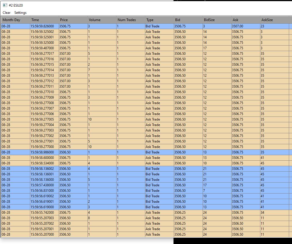

[2020-08-30 17:45:59]
Update to Post #67.
Explored further on this. Interestingly the same data works fine and displays correctly(DateTime) during replay. Same T&S data gets counter based time immediately after the replay. (Same chart/instrument - no other changes). The T&S data is from Friday - when the charts were running.
SC Team - Would you please review and comment?
Date Time Of Last Edit: 2020-08-30 20:14:24
imageSC_TS_Data_AccurateDuringReplay.JPG / V - Attached On 2020-08-30 17:44:52 UTC - Size: 229.54 KB - 1231 views
imageSC_TS_Data_ImmediatelyAfterReplay_Incorrect.JPG / V - Attached On 2020-08-30 17:45:00 UTC - Size: 232.81 KB - 1181 views
[2020-08-31 13:29:52]
Post # 67 & 68 can be marked as closed. Read the release notes for 2156 and apparently related to Market Data servers update. All good now with respect to the T&S data displayed correctly now.
https://www.sierrachart.com/index.php?page=doc/Whats_New.php#SCVer2156
