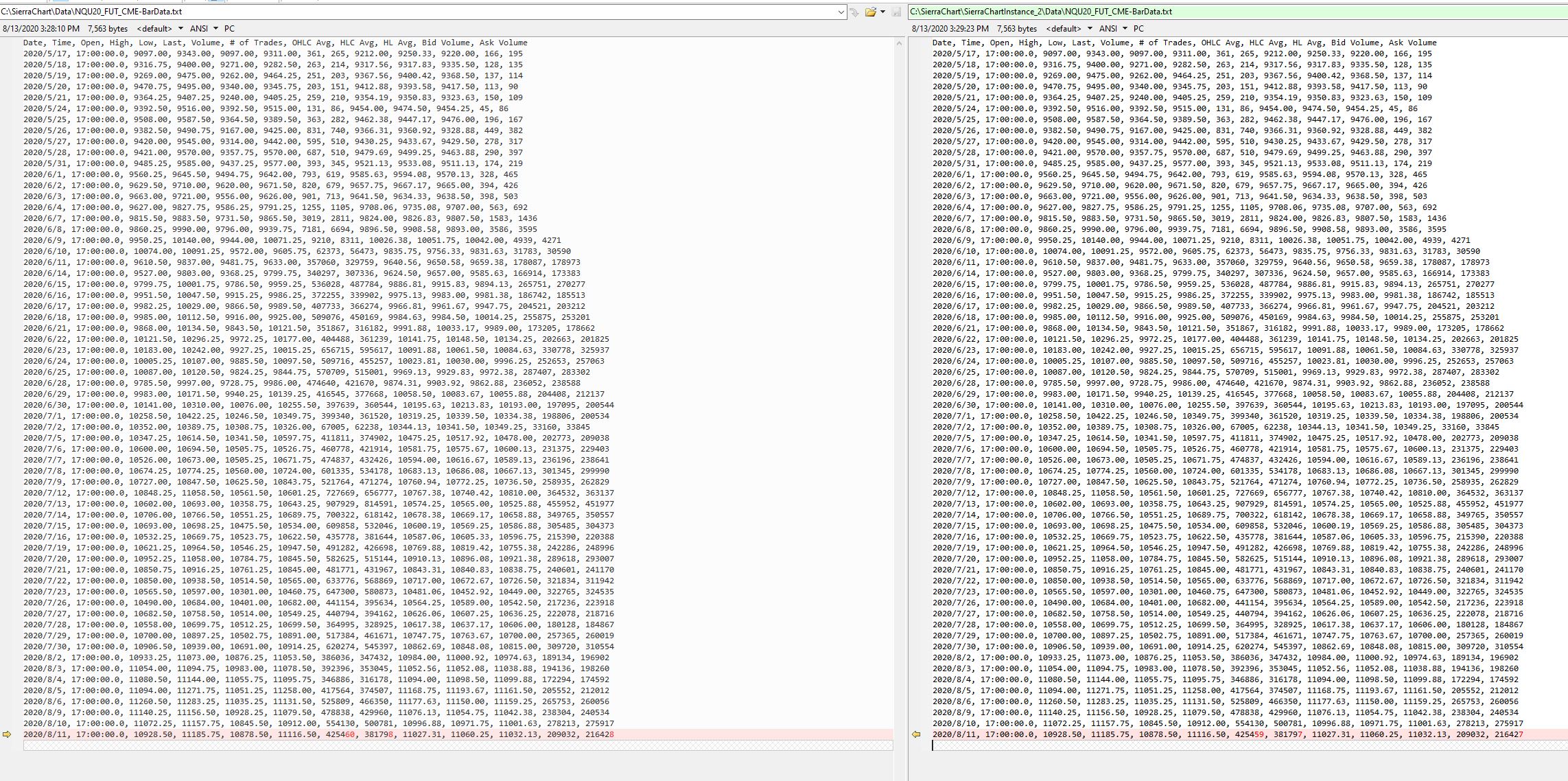

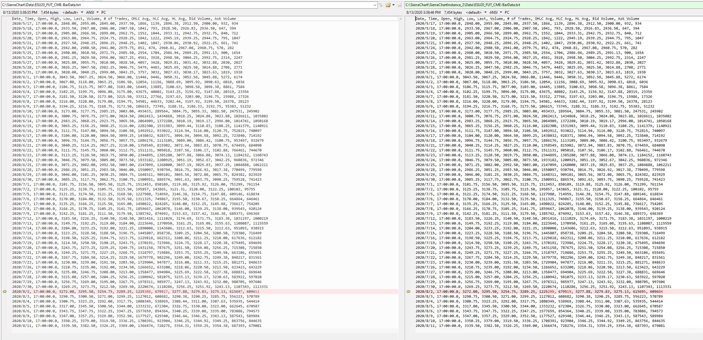

ejtrader - Posts: 689
SC Team - I don't have the volume filter turned on. Attached are the 2 files with Write Bar data for the same charts. Difference is one single day - 1 trade (for 8/11).
attachmentNQU20_FUT_CME-BarData_Main_Instance.txt - Attached On 2020-08-13 20:35:45 UTC - Size: 7.39 KB - 517 views
attachmentNQU20_FUT_CME-BarData_Sub_Instance.txt - Attached On 2020-08-13 20:35:53 UTC - Size: 7.39 KB - 415 views
[2020-08-13 20:37:08]
Attached is the image that is showing the difference for 1 day.
First one is for NQ - Difference on 8/11 - 1 trade difference.
Second one is for ES - Difference on 8/2 - 9 Trades differ between main on Sub-instances
Date Time Of Last Edit: 2020-08-13 20:42:43
imageNQ_Data_Difference.JPG / V - Attached On 2020-08-13 20:42:27 UTC - Size: 931.5 KB - 491 views
imageES_Data_Difference.JPG / V - Attached On 2020-08-13 20:42:36 UTC - Size: 912 KB - 464 views
