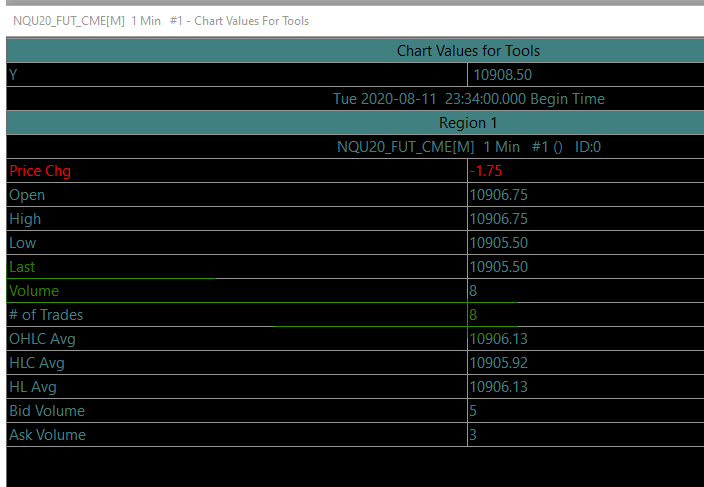

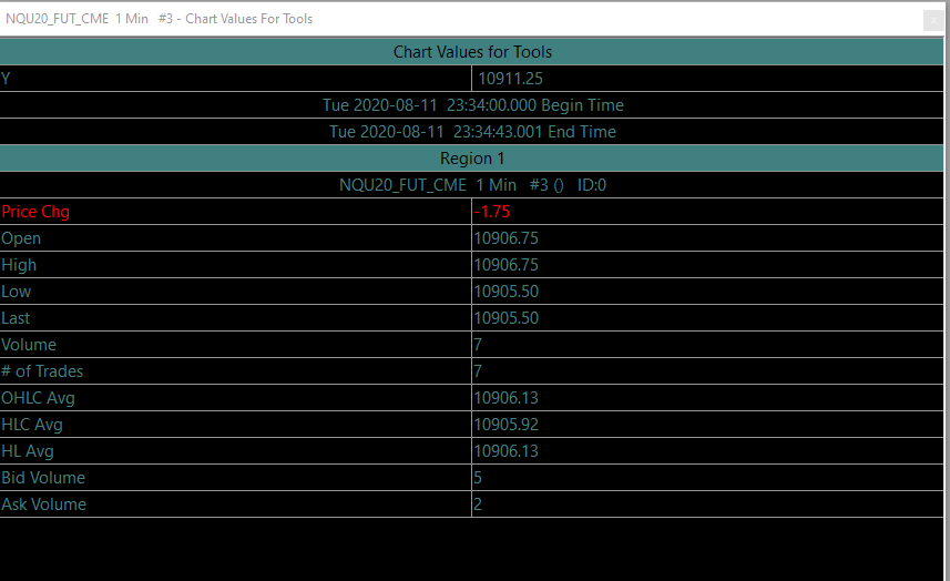

SC Team - Noticing few issues with the Number of Trades/Volume between Main instance and Sub-Instance. Attached are 2 images demonstrating the issue.
If you could look at the data for the same bar - The End time/# of trades/Volume are different between Main instance and sub-instance. I have looked at the underlying T&S/SCID data between main instance and sub-instance and in sub-instance the data for 23:34:43.002 is missing where as it is present in main instance.
23:34:43.000 & 23:34:43.001 - Present in both main and sub-instances.
23:34:43.002 Trade:
In Main Instance - Showed up in T&S data, Present in SCID file, Shows in Chart
In Sub Instance - Showed up in T&S data, missing in SCID file, Missing in Chart
This is a serious issue as unable to trust the Sub-Instance to process critical data.
PS: I am using CST as timezone across the charts/instances for this. This is not a single occurrence as have been noticing the issues in different areas as well. Same code produces very subtle differences between main instance and sub-instance.
