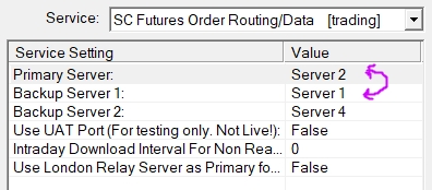

[2020-07-08 08:51:08]
User156295 - Posts: 105
So now should I change servers with each other as attached? https://i.imgur.com/jAMGDok.jpg

[2020-07-08 11:24:58]
So pls tell me how to having opened Data/Service Settings window as question relates to this window and while keeping it open it is impossible to go to Edit>Screen Images to make a screentshot or I miss smth.
Date Time Of Last Edit: 2020-07-08 15:18:21
[2020-07-08 19:08:07]
In this case you just need to use an external screen capture utility and then just attach the image file here:
[2020-07-08 19:22:49]
Got it, attached.
imagejAMGDok.jpg / V - Attached On 2020-07-08 19:20:43 UTC - Size: 48.53 KB - 501 views
[2020-07-08 19:40:22]
Yes just reverse those two server settings that you currently have set.
