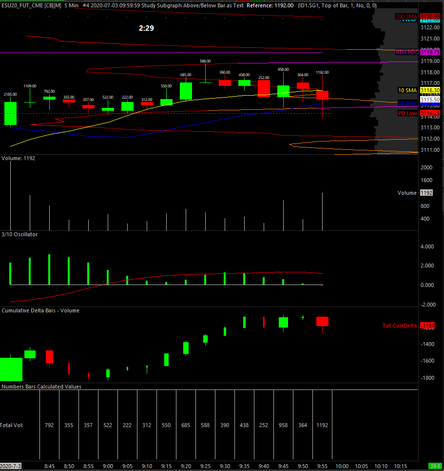

Hey Jeffrey - you can use the study: Number Bars Calculated Values -- then, using the study, pull in whatever you want, including volume.
You can also display the volume above the candles using the study: Subgraph Above/Below Bar as Text. See attached screenshot.
imageDisplaying Volume.png / V - Attached On 2020-07-04 01:43:53 UTC - Size: 39.61 KB - 489 views
