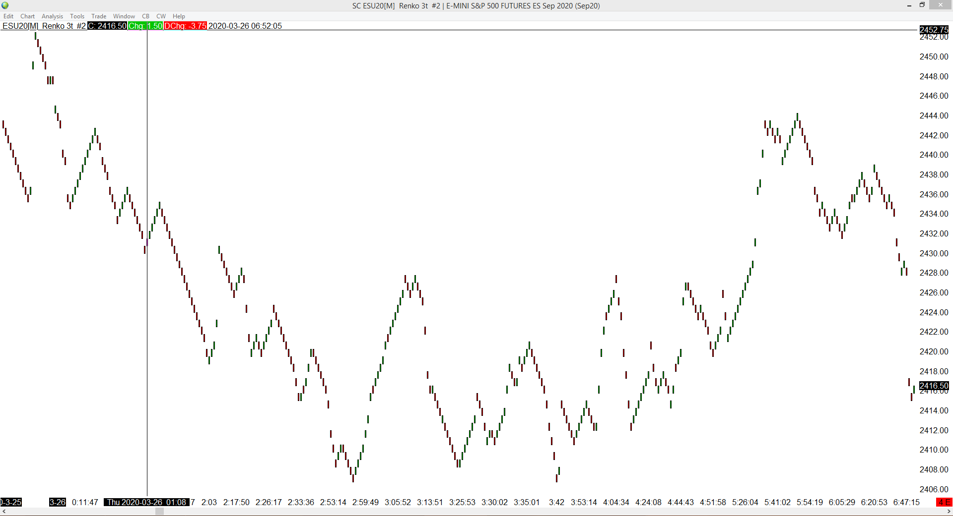

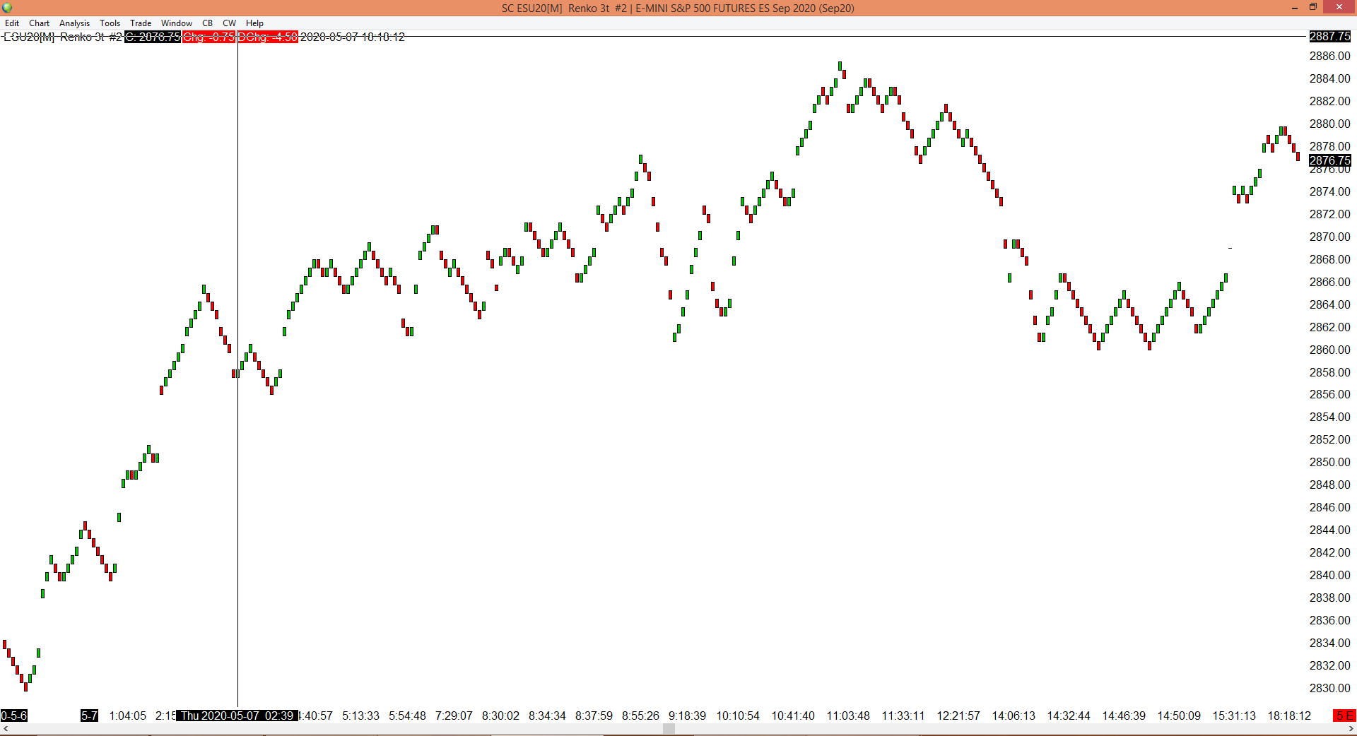

Dear Engineering team,
I have a little issue with Renko Chart. The bars look fine for the first couple days. But if I go back further, the historical bars do not load properly. They are out of place and there are many gaps among them. I try deleting and reloading function. It doesn't resolve the issue. I have attached a few examples for your review. Please help.
Thank you,
imagepic1.PNG / V - Attached On 2020-06-17 02:09:49 UTC - Size: 58.02 KB - 337 views
imagepic2.PNG / V - Attached On 2020-06-17 02:09:53 UTC - Size: 59.7 KB - 381 views
[2020-06-17 03:21:12]
You need to set the chart to be a continuous futures contract chart:
