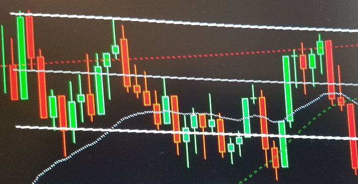

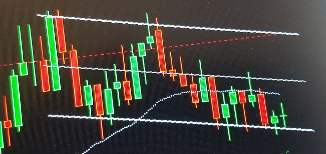

User414533 - Posts: 123
Hmmm... I will try to take a before and after photo next time it happens.
Basically I set up a channel and extend the lines so it functions like a ray. As price progresses, the channel lines will move (usually wider) than what I set up. It gets confusing because as the trading day progresses and I revisit my older channels, I notice several are usually a bit screwy (lines that used to be at candle closes are now further above/below the original placement.
I read on the Sierra documentation that this has something to do with calculating the angle beyond the locked fill space. It doesn't make sense to me. Why can't a locked channel stay along the line it was originally placed... new candles be damned? :/

[2020-06-05 19:29:55]
Okay, thank you! I believe that answers my question. Just to be certain: When setting a line, do not extend it past the last visible candle. After the line is established, I can then "extend drawing" with no fear that my angle will be changed in the future?
