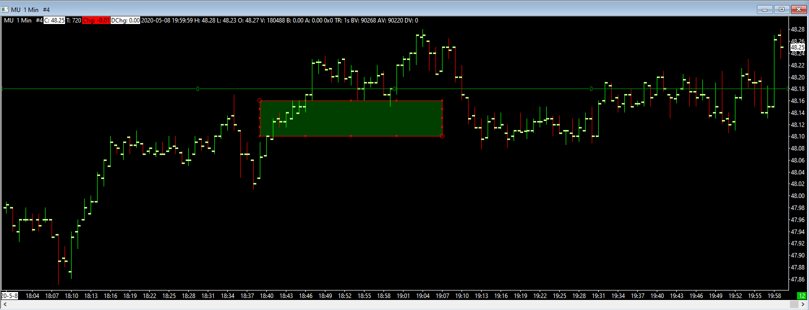

I tried what you asked. Something new happened.
I created a new chart, drew a horizontal line and a rectangle. Selected TOOLS >> MOVE DRAWING.

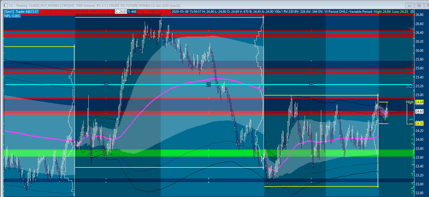

As you can see from the attached (MU.png), only the horizontal line has the numbers. There are no numbers on the rectangles. Note that in my previous examples, the drawings were all rectangles. Note that this was on a brand new separate installation of SierraChart.
So I tested my previous charts by drawing a line and I get the same thing. See OldChartWithLine.png
imageMU.png / V - Attached On 2020-05-10 07:26:37 UTC - Size: 42.08 KB - 398 views
imageOldChartWithLine.png / V - Attached On 2020-05-10 07:28:55 UTC - Size: 79.33 KB - 365 views
[2020-05-10 11:37:00]
Okay we see the reason for the problem now. We will resolve this in the next release.
