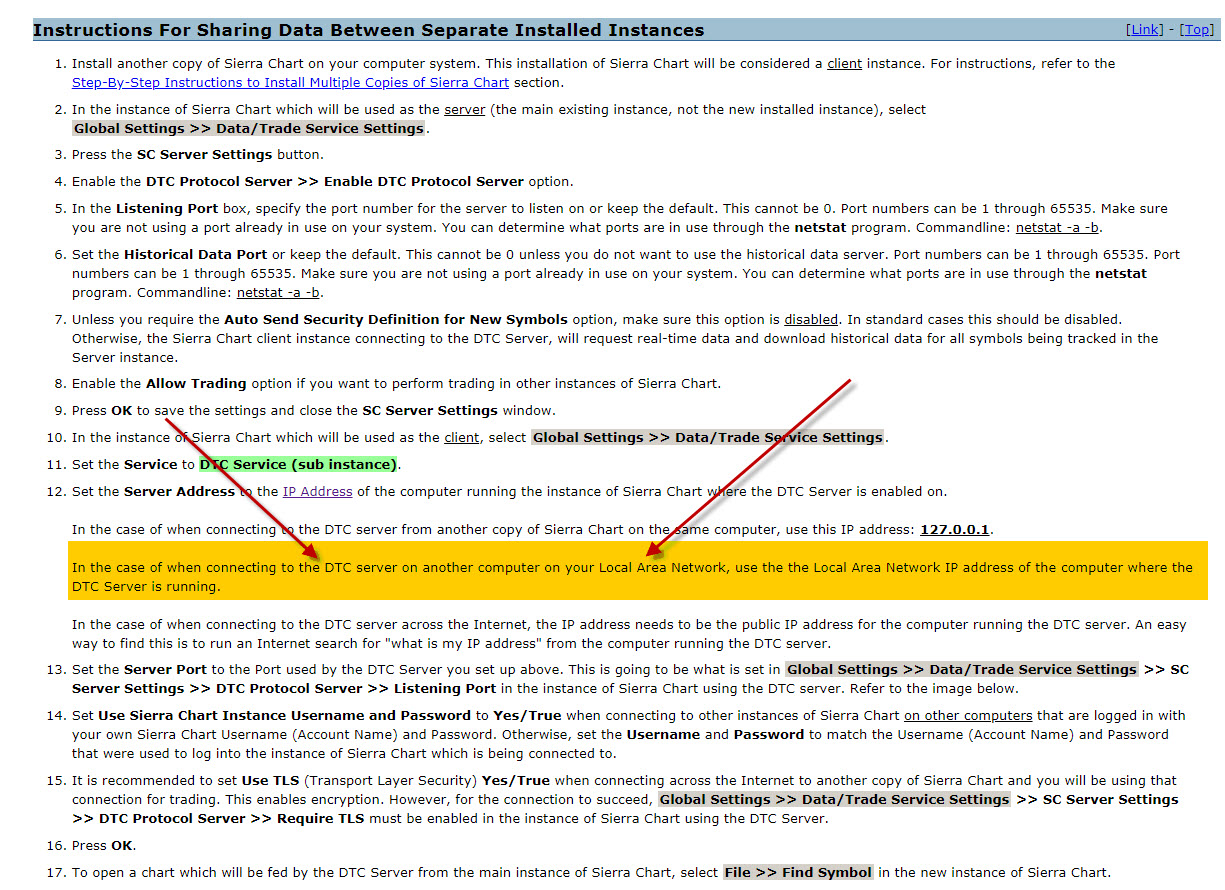

could it be possible to use now the DTC server for sharing the data on the second pc?
No we cannot allow that due to exchange rules.
The answer is no to post #2. The exchange rules do not allow what you are suggesting and the DTC Server is designed to only allow market data requests from the same computer system. If you require using two computers, then you simply will have to pay the exchange fees twice.

[2020-05-03 23:44:54]
No, that is not going to work.

User75949 - Posts: 142
On the same pc I've been able to make it work a separate installation and it is working fine.
Following the Sierra Charts instructions, it seems it can be done also on the second PC conn:
Using DTC Server for Data and Trading in Another Sierra Chart Instance
as you see from the screenshot
Tryed following the instruction but seems not to work
regards
