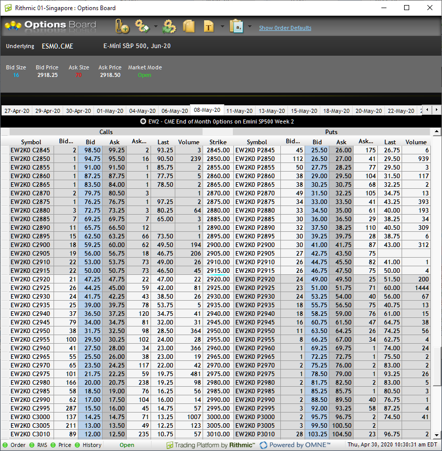

Usually, platforms that handle options ask for the underlying symbol, for example, ES again, then the expiry date, then it will pull up a board that looks like a spreadsheet listing calls on one side and puts on another like the picture shown here. on Rtrader as shown you can then right-click on any strike and it will pull up a dom to trade that strike, whether a call or put, or you can manually enter the symbol string in an existing dom, chart etc. Not sure how deeply you want to get into this can of worms, but being able to have options with correct pricing on a DOM is a great thing for trading
image2020-04-30 10_30_31-Window.png / V - Attached On 2020-04-30 14:35:25 UTC - Size: 157.06 KB - 551 views

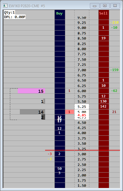

I would forgo additional option functionality, for 2 things: the expanded options list as you described here Real-Time Exchange Data Feeds Available From Sierra Chart: Futures Options and the ability for a user to set a threshold for tick increments on the dom, so I could have 2 different tick increments depending on a price threshold. This is necessary for ES options as explained before. See here for an example of how an options dom is impossible to trade with a .25 tick increment under the $5 threshold
image2020-05-01 09_21_33-Window.png / V - Attached On 2020-05-01 13:54:50 UTC - Size: 23.02 KB - 489 views
[2020-05-02 07:20:16]
It is very impractical to be supporting different Tick Sizes at the same time on the price ladder/column. There could be a change between tick sizes based upon the current price. That would be the only practical thing we could implement.
Date Time Of Last Edit: 2020-05-02 07:20:36
