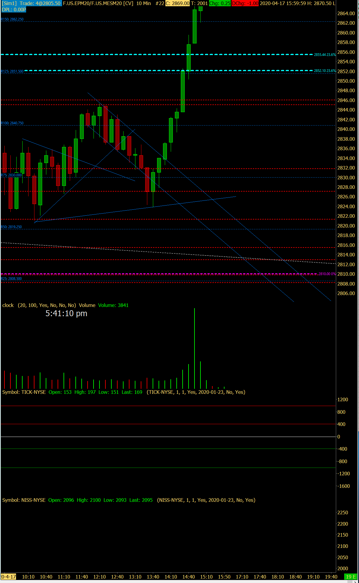

I'm trying to add TICK-NYSE and NISS-NYSE to the chart but it doesn't display. I had data. I tried adding future symbols too but still doesn't show up. Please see attached what it looks like.
imagesierra-chart-tick-dont-work.PNG / V - Attached On 2020-04-17 22:44:07 UTC - Size: 91.23 KB - 316 views
[2020-04-18 00:42:47]
This is unusual.
Maybe it is a color settings issue:
Color Settings for Graph Draw Types
Do you see a chart for those symbols when you open separate charts for them?

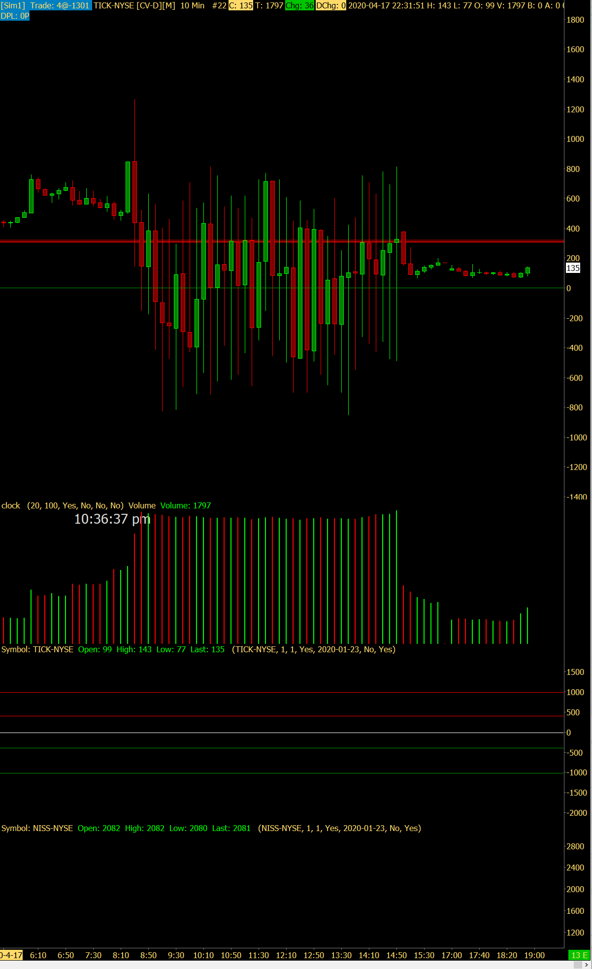

I can see when I pull up TICK-NYSE in the main chart. See attached.
imagetick.PNG / V - Attached On 2020-04-18 03:40:22 UTC - Size: 116.35 KB - 340 views
[2020-04-19 08:07:57]
Open the Study Settings window for the Add Additional Symbol study and check to see what the Graph Draw Type is set to:
Chart Studies: Subgraphs Tab >> Graph Draw Type
[2020-04-19 13:46:21]
User811622 - Posts: 38
I had it set to blank. After I set to candlestick, I can see the chart just fine now. Thanks so much for your help.
