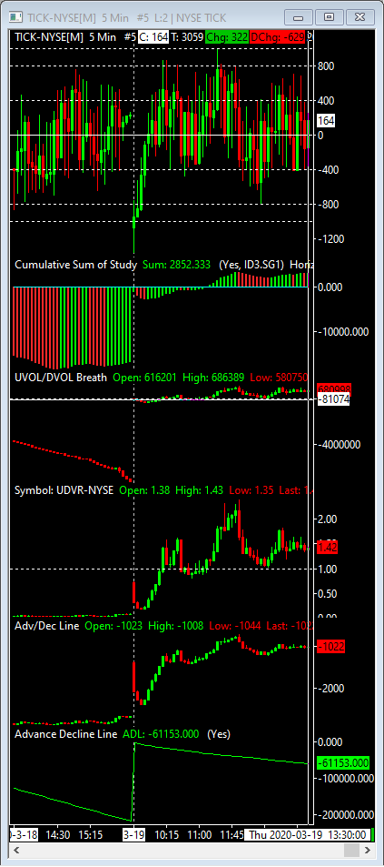

Is there an issue with the NISS-NYSE data today?
I am showing a -1000 when others are showing a +1000 roughly?
also the Adv/Dec Line study is showing -60,000 area??

We checked all of the component calculations for the NISS-NYSE statistic, which includes the number of stocks traded, the number of advancing issues, the number of declining issues, and the daily price changes. All of this is correct. The market is down today, so we would expect this to be a negative number. So we have to say the others are wrong.
Component calculations:
TISS-NYSE, ADV-NYSE, DECL-NYSE
The one thing you cannot see are the daily price changes of the individual stocks, but we did look at a few of those and they are all correct.
But clearly a value of +1000 cannot make any sense being the market is down. So as you can see the others are providing faulty statistics when Sierra Chart is correct.

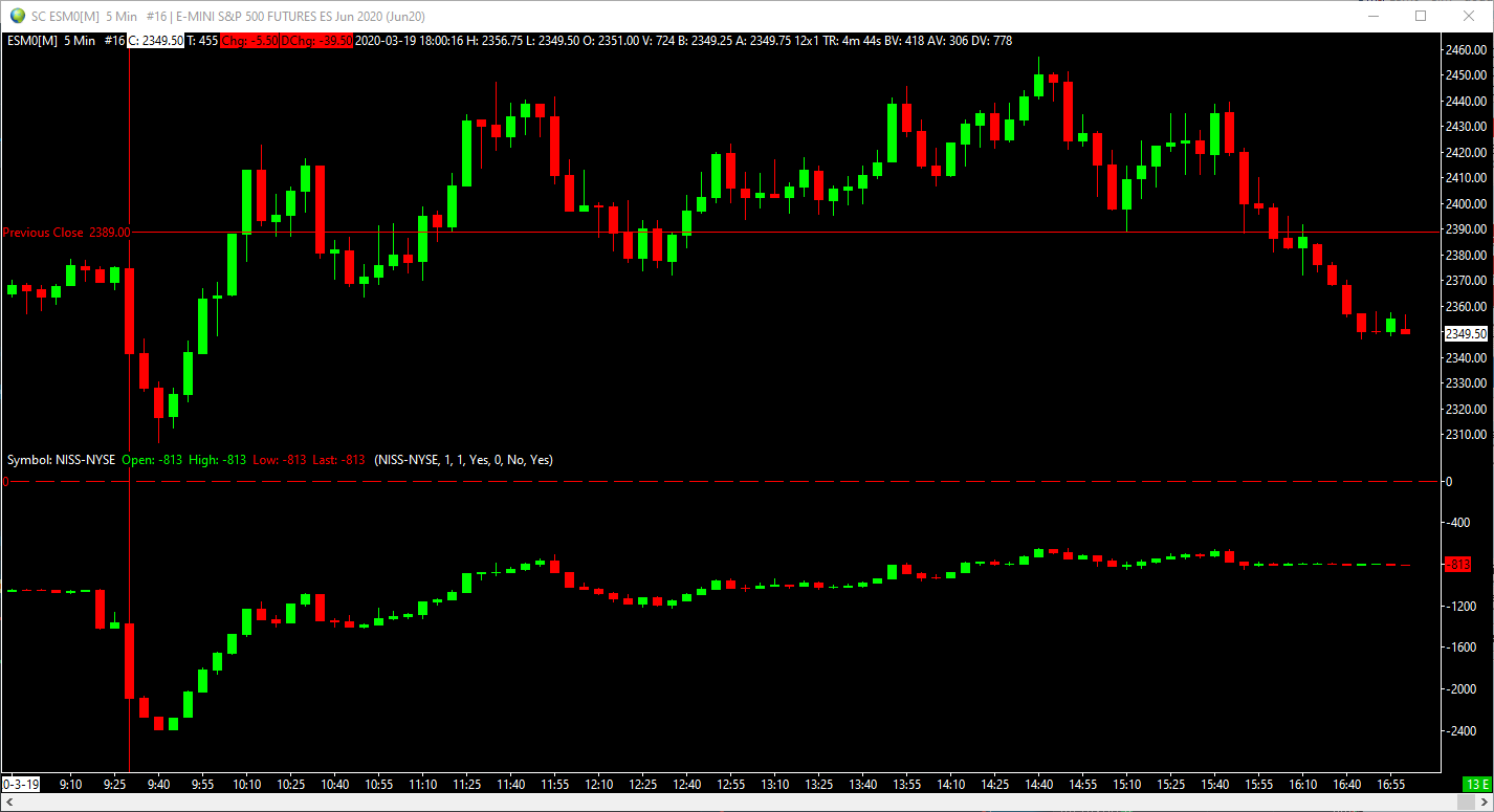

I have attached another chart that shows the ES and Adv/Dec and previous close and where the market was green during the day.
But the ADL never got close to 0 the whole day. Maybe I am just missing something? maybe others can share with me what I am missing?

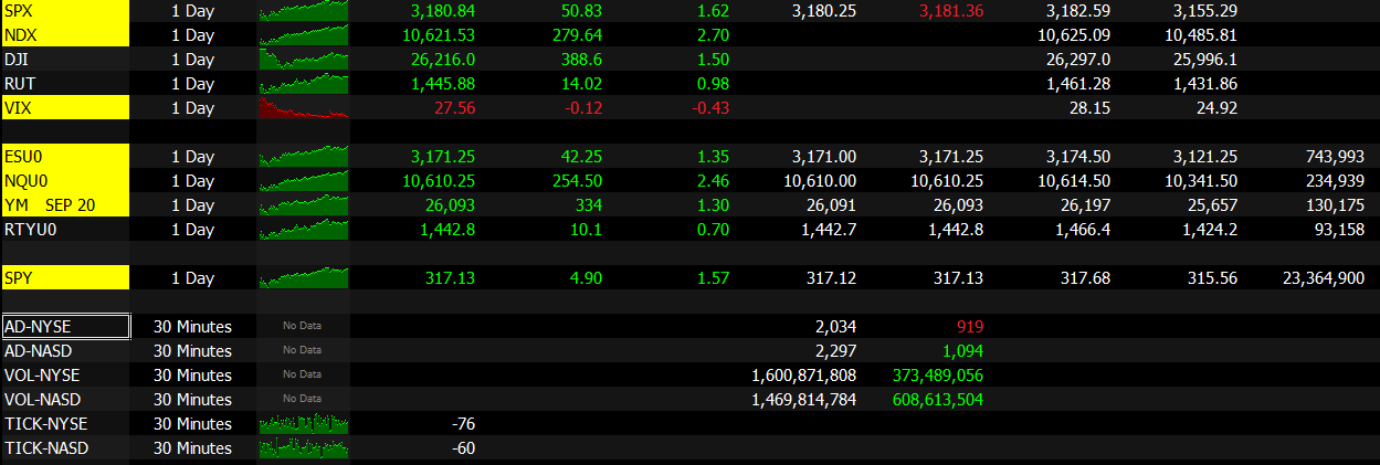

[2020-09-11 16:53:09]
Profile Trader - Posts: 182
SC,
The ADD for both the NYSE and NASDAQ have been wrong all day. Let me know if you need screen shots and supporting data.
NYSE has been positive all day but SC shows it negative all day.
There seems to be a reoccurring concern with internals.
Doug
[2020-09-11 17:32:41]
We know why this problem has occurred this time. It relates to the daily price change and why that is not correct is do to a very unusual circumstance. It will be corrected after the close today. But the existing market statistics data depending upon that will not change.
Date Time Of Last Edit: 2020-09-11 17:32:54

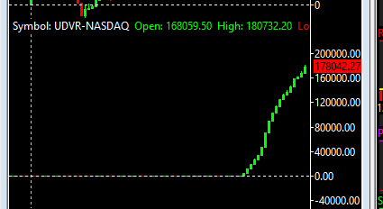

Something is going on with up down Volume Ratio for Nasdaq today???
imageUDVR Nasdaq.png / V - Attached On 2020-11-30 20:54:54 UTC - Size: 7.34 KB - 429 views
[2020-11-30 22:48:06]
The best we can deduce from this right now is there may have been an integer overflow condition. There is nothing we can do with the faulty values other than clear them which we will do.
And we will solve the integer overflow problem.

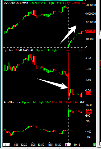

[2021-01-12 15:47:16]
The UDVR(NAS) has something going on with it today. It is showing a much different number then another platform and if you look just the up down volume it is raising but the Ratio is falling or flat.
imageUDRV Nas.png / V - Attached On 2021-01-12 15:46:57 UTC - Size: 22.97 KB - 448 views
[2021-01-14 21:59:23]
Sierra_Chart Engineering - Posts: 25370
Letting you know we are looking over this. This is fairly involved to analyze. It will be many days.

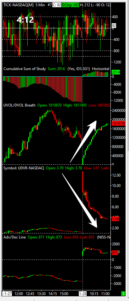

[2021-01-28 16:13:52]
Not sure I completely understand how this can be happening?
Seems like the rise in volume should be changing pace or slope with that amount of drop in Ratio.
Date Time Of Last Edit: 2021-01-28 16:15:33
imageNas UDVOL and Ratio 1-28-21.png / V - Attached On 2021-01-28 16:13:02 UTC - Size: 37.62 KB - 425 views
