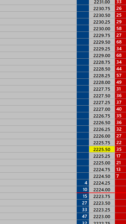

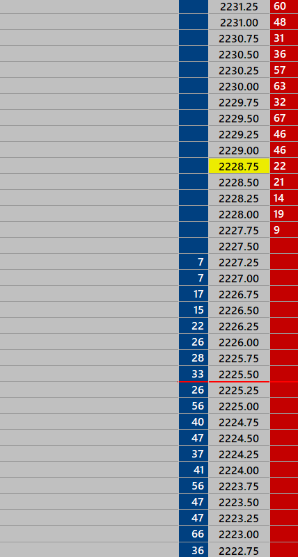

I switched to the sierra data with order routing like suggested but my replay mode still has a delay. Price and the bids/ask are not sync, see the images that i attached.
imageScreenshot_1.png / V - Attached On 2020-03-23 19:00:21 UTC - Size: 28.23 KB - 376 views
imageScreenshot_3.png / V - Attached On 2020-03-23 19:00:28 UTC - Size: 27 KB - 346 views

We have looked into this. You should only be noticing this issue occasionally. We know why it happens. It only happens when there is a significant price move over a period of one second. It will be resolved once true millisecond time stamping for trades is released. We are doing our best with that, but it is very involved.
Date Time Of Last Edit: 2020-03-24 20:09:03

Well it happens all the time, i mean price and bids/asks are never in sync and it feels like price is the problem because bids/asks are moving rather smoothly but price jumps around. I can record my screen and send it if you like.
[2020-03-25 08:05:50]
We do not need to see anything further. Our observations were during the nonregular trading hours. We understand the problem and we will be working on a solution as soon as possible.
