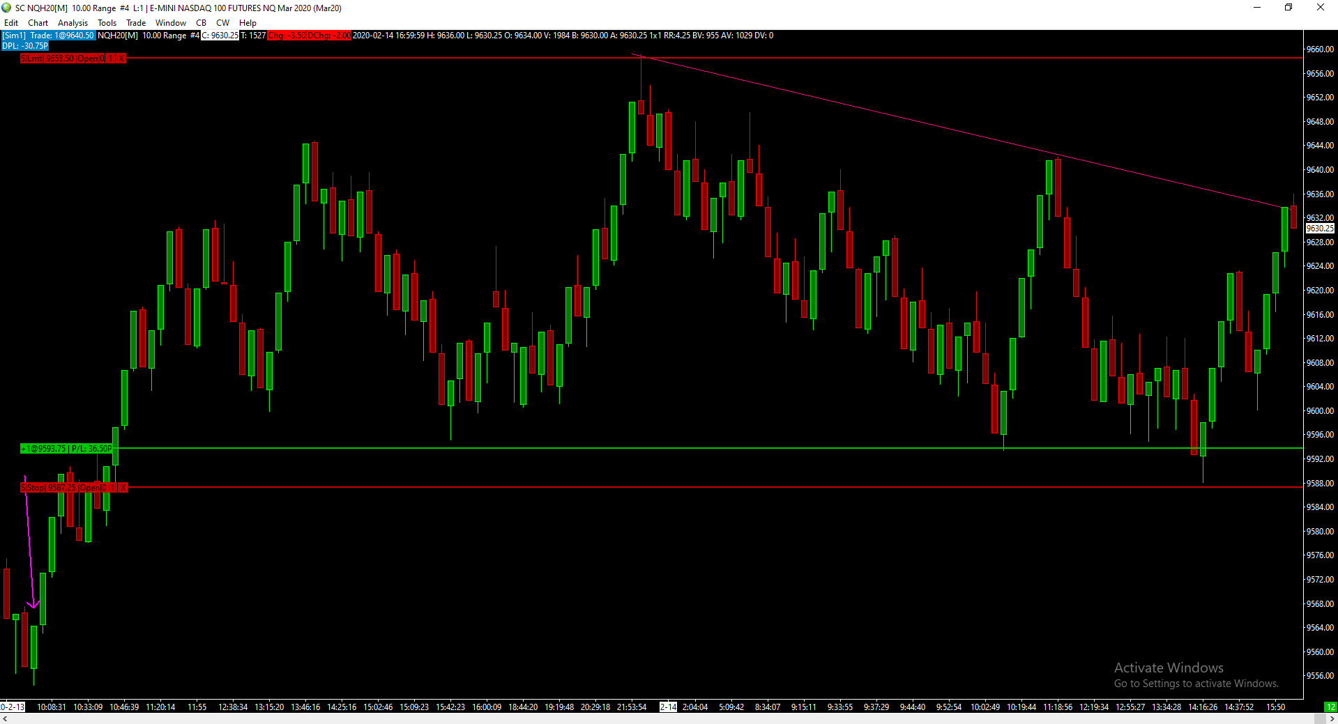

I tried that, but when I set the first anchor, you can see it does not line up. I set the anchor to the top of this candle and it is slightly below it.

When I did this and followed the instructions, it would give an error in the SC main data log. I stripped the chart down and put only the line that was making the error. You can see at the top of the first candle the trend line is attached to.

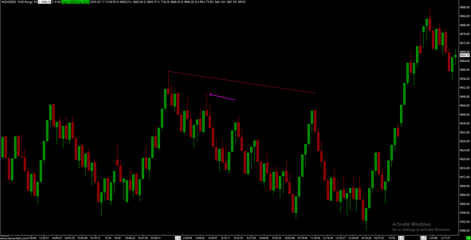

Thanks. I updated my version and uploaded the image. Is this an error in programming that needs fixed or is there something I can do about it? You can see when I set the 2nd anchor it is way off from the intended top where the purple arrow is. This is roughly 20 ticks from the actual anchor point.

We are very confused by the last image you added and your statement about it. Where exactly did you place the anchor points for the line in that image? Was the line originally lined up to that bar that is pointed to with the purple arrow, or was it off when you placed the line?

Yes. The line was on the top of the candle tail before I manually typed in the 2nd anchor. It moved after I typed it in.
